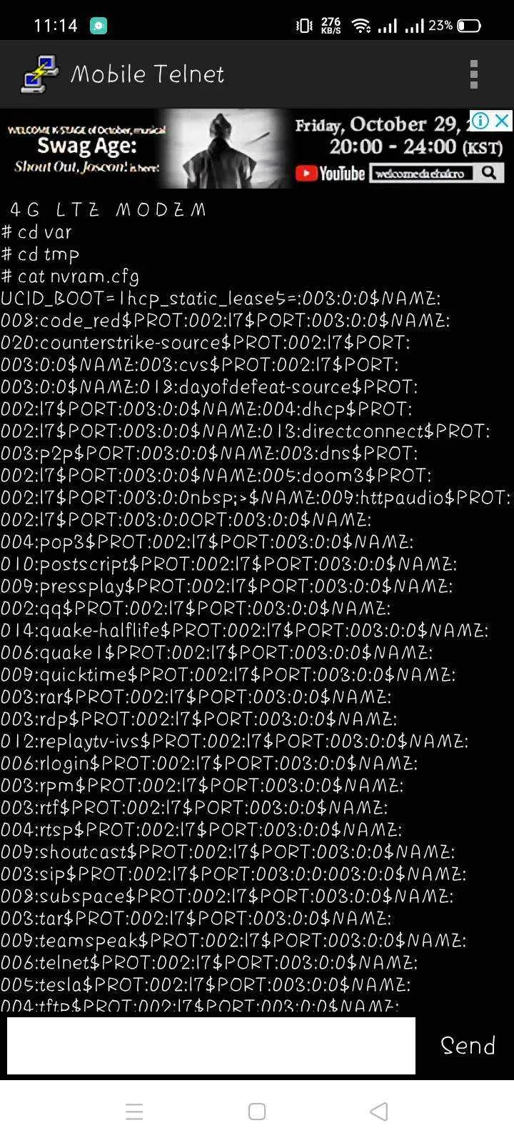

6. After Log-in, need to access nvram.cfg
update 11/1/2021
a. type on the console "grep -i "http_passwd" /tmp/nvram.cfg" then press enter; sample below superadmin pass om0mYXQ7
first release: this process is override
a. type on the console "cd var" then press enter
b. type on the console "cd tmp" then press enter
c. type on the console "cat nvram.cfg" then press enter - this will open the file
screen shot. search the below in red
7. now you have the Superadmin password...

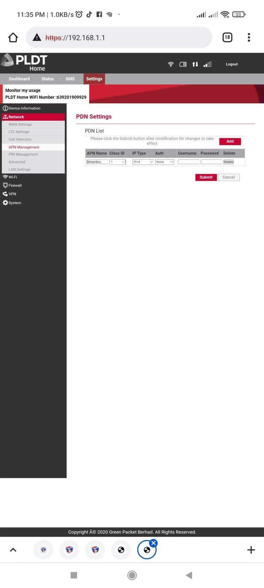

okie po salamat idol laking tulong po tong superadmin sana magawan ng paraan saka idol last question nlang kasi pag mag open ako ng 192.168.1.1 webui nya sa android phone ayaw mabuksan pero sa pc/laptop okey nman po sya may remedio po ba kayo niyo sir
Sir di gumagana sken ung nvram.cfg bakit gnun
D ko din nasubukan gamit ang cp. Mas comportable ako sa pc. Pero itry ko din gawin yang cp sa pag access. Check mo din pala ang port, 23 if di gumana try mo port 22
