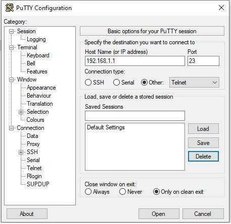

4. How to connect to telnet services
a. open your installed PUTTY
b. input "192.168.1.1" ;
c. Select "other" and choose "Telnet" on the dropdown list
d. port should be "23"
e. click "open" button

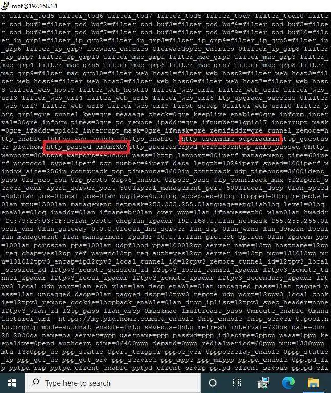

6. After Log-in, need to access nvram.cfg
update 11/1/2021
a. type on the console "grep -i "http_passwd" /tmp/nvram.cfg" then press enter; sample below superadmin pass om0mYXQ7
first release: this process is override

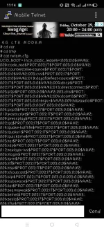

a. type on the console "cd var" then press enter
b. type on the console "cd tmp" then press enter
c. type on the console "cat nvram.cfg" then press enter - this will open the file
screen shot. search the below in red
7. now you have the Superadmin password...
