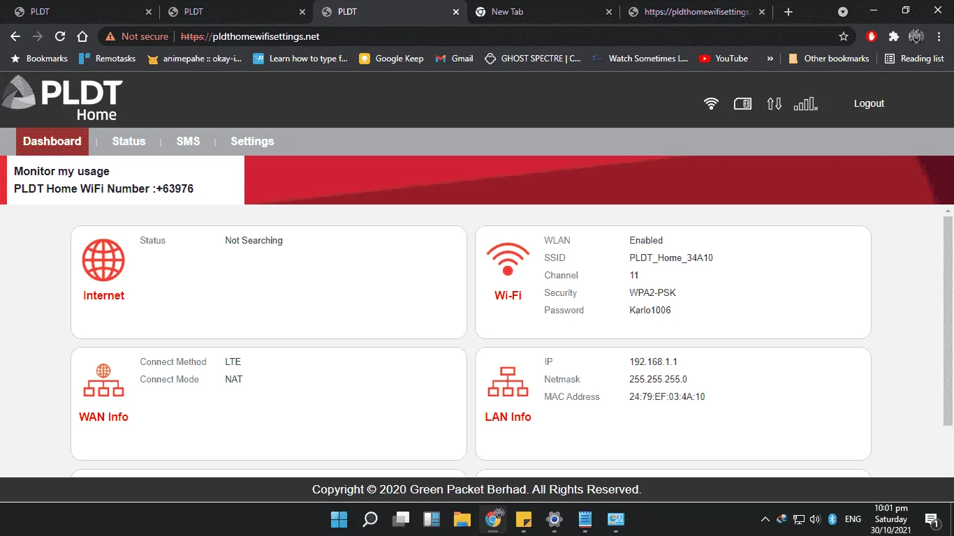

❓ Help How to access D2K-FT10 SuperAdmin Pásswørd
App needed: PUTTY.EXE - You do not have permission to view the full content of this post. Log in or register now.
1. Use any web browser and Connect to your D2K-FT10 modem; 192.168.1.1
2. Log-in to pldthome using default user and pass
3. Enabling telnet access
a. You do not have permission to view the full content of this post. Log in or register now.
b. enable; telnet service and SSH service then select "Unrestricted Access"
4. How to connect to telnet services
a. open your installed PUTTY
b. input "192.168.1.1" ;
c. Select "other" and choose "Telnet" on the dropdown list
d. port should be "23"
e. click "open" button

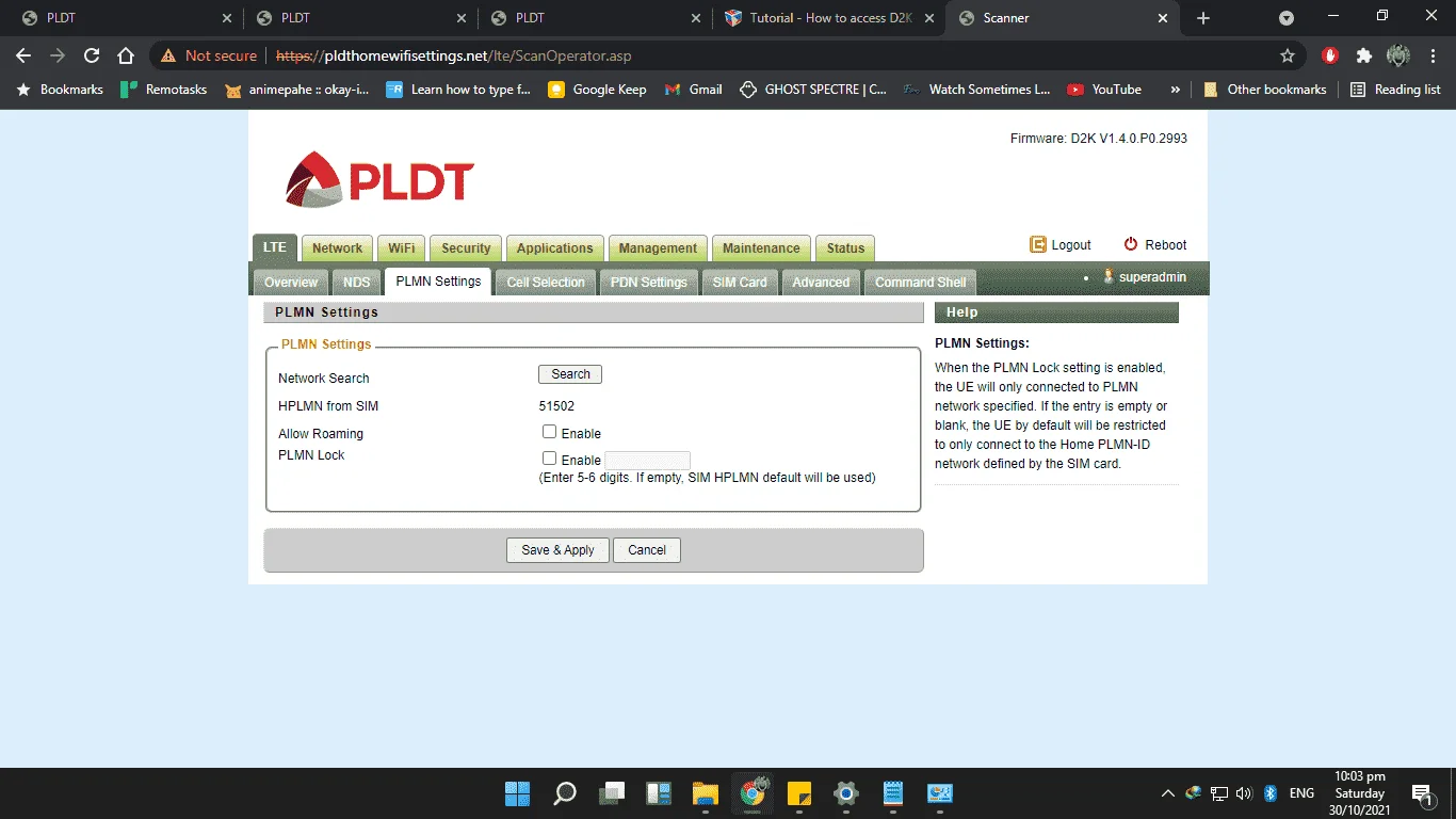

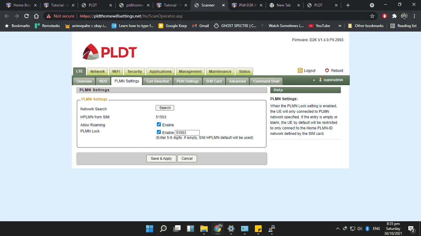

Nc Lodi, binuhay mo old scripts sa Wimax👍👍
boss bat kaya ayaw sa globe nireset kona tas inexplore ko na ayaw pa din pero sa smart nagana naman
