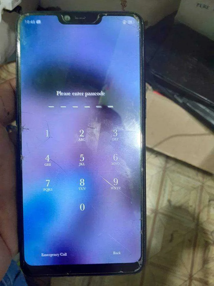

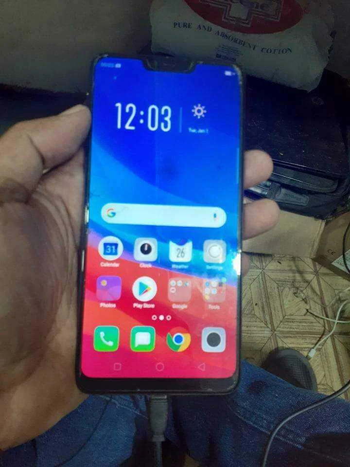

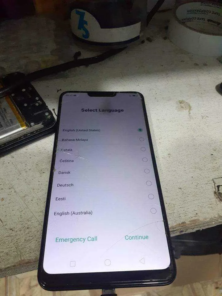

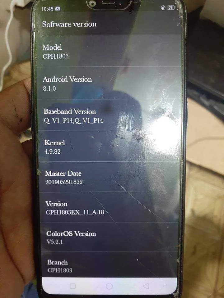

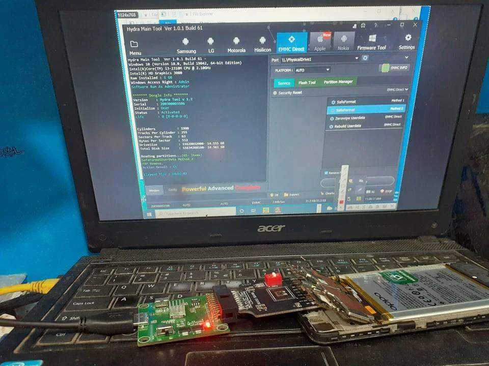

🔒 Closed HYDRA MAIN TOOL REMOVE Pásswørd ON OPPO A3S CPH1803 DONE...

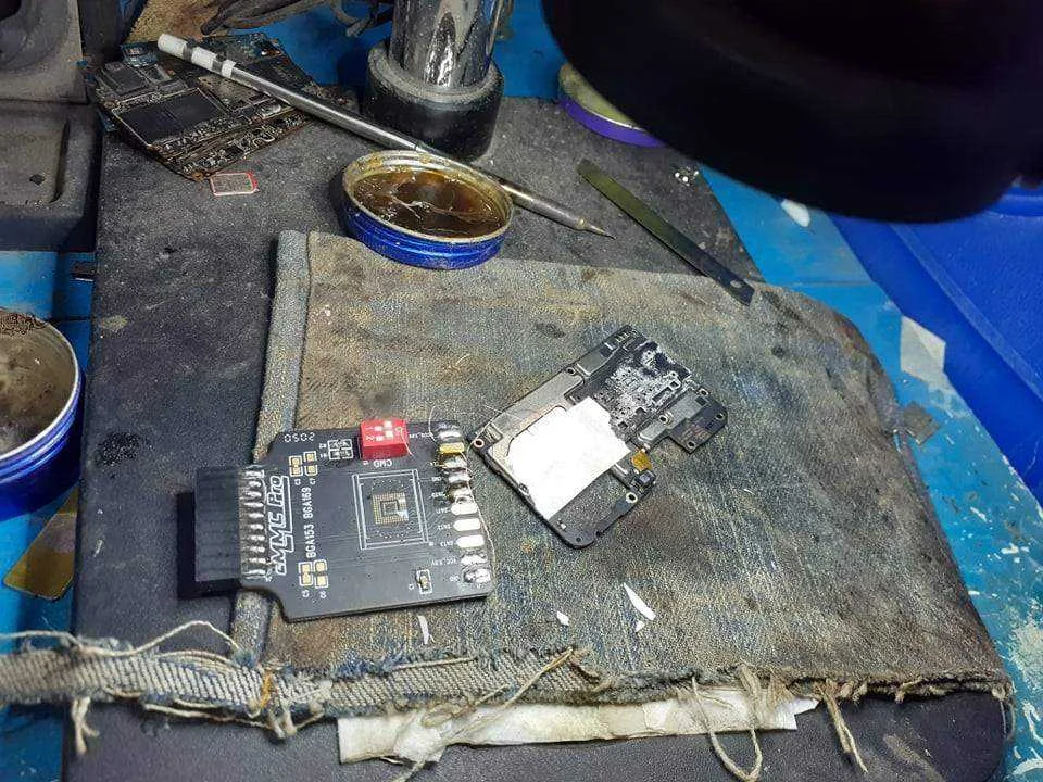

mga dapat gawin po

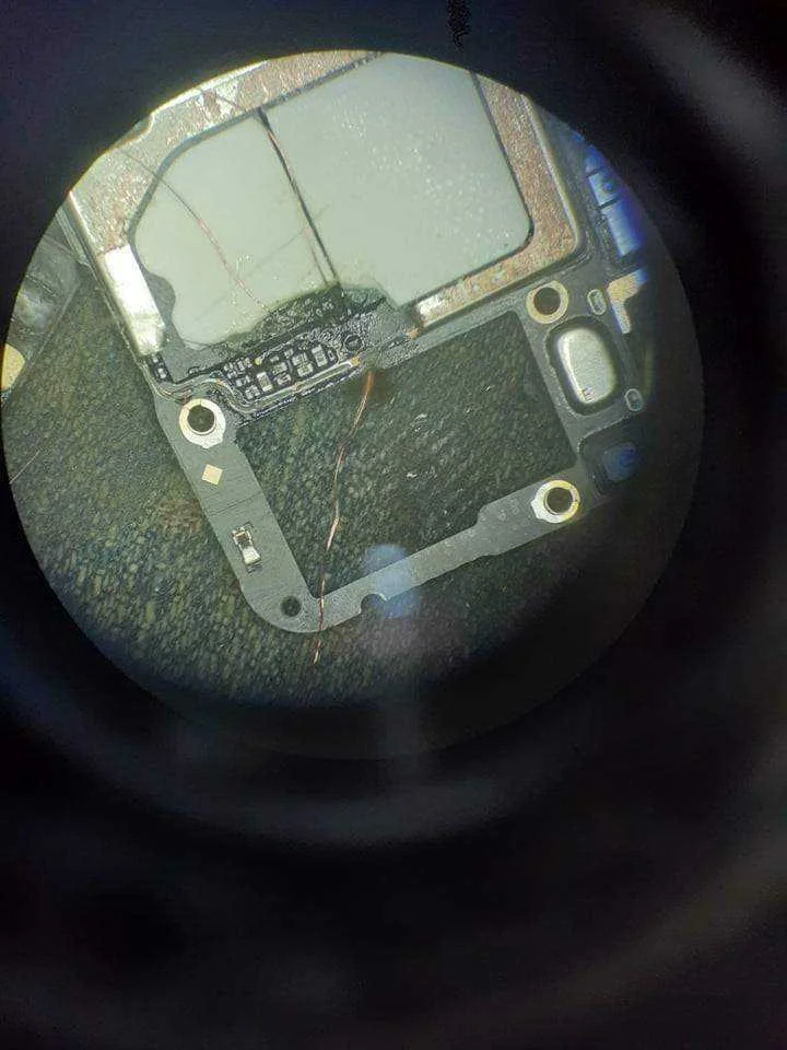

connect TP to ISP
connect ISP USB to PC and to ISP port
open main hydra tool
use Emmc
port: \\.\PhysicalDrive1
Flatform: Qualcomm
safe format--method 1 or method 2
execute
hintayin po bago matapos
