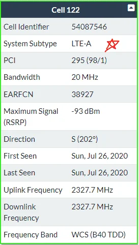

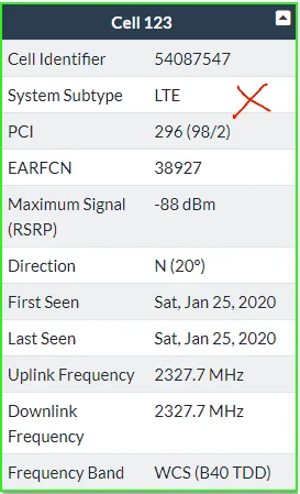

Gamit ka cellmapper. Check mo muna kung saang tower ka naka-connect. Once malaman mo kung saan tower ka naka-connect, check mo kung aling bands ang CA-supported usually nakalagay s'ya sa system subtype. Kung supported ng band ang CA, nakalagay don is LTE-A. Kung hindi naman supported, LTE lang ang nakalagay.
For example, this is LTE-A supported band
And this is NOT.
Kaya depende kung anong band ang may CA support sa cell tower kung saan ka naka-connect. :)
PS. Yes, 4G+ ang indication ng LTE-Advanced.
And this is NOT.
And this is NOT.
