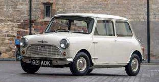

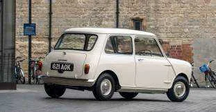

Pictured – 1959 Morris Mini Minor. The BMC Mini was widely credited for bringing the transverse FWD layout into the mainstream…

The car credited with popularising the transverse engine layout has widely been thought to be the British Motor Corporation (BMC) Mini from 1959 designed by Sir Alec Issigonis, which set the ball rolling for a whole genre of compact, front-wheel-driven cars from that point on.

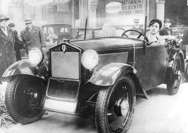

…although the 1931 DKW Front F1 was first of the type to sell at volume, with its transverse two-cylinder two-stroke engine
Packaging of drivetrain in the DKW Front F1 was more akin to the present-day front-wheel drive car; while its two-cylinder, two-stroke engine was from the pre-war era of DKW, transmission was by a clutch and gearbox which were mounted inline with the crankshaft.

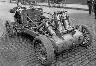

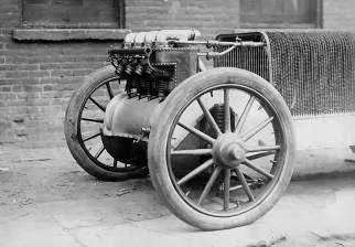

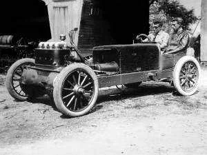

1908 Christie with a transverse, narrow-angle V4 engine (top row). This was preceded by the 1904 Christie Blue Flyer (second row), which appeared to have an inline-four cylinder engine. Click to enlarge

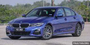

This has been exemplified by the You do not have permission to view the full content of this post. Log in or register now. and the You do not have permission to view the full content of this post. Log in or register now., both long held as benchmarks in handling. For both the 3 Series and the MX-5, not driving the front wheels meant their engines needn’t be ahead of the front axle line, and could therefore be tucked as far back as possible to aid weight distribution.

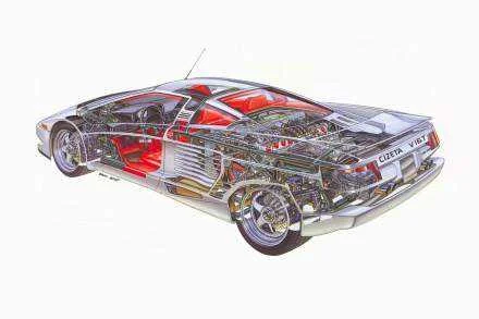

Attention – Wide loads. The Lamborghini Miura and Cizeta-Moroder (afterwards just Cizeta) V16T packed transverse multi-cylinder engines behind its occupants

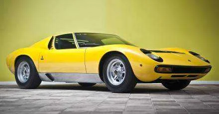

Most, because from Lamborghini there was of course the Miura, which mounted its V12 engine transversely in its bay behind the occupants.
A slightly more recent example of the transverse peg in a longitudinal hole is the Cizeta V16T that first emerged as a concept in 1988, which featured what was essentially a pair of Lamborghini Urraco V8 engines – conjoined end-to-end to make a 6.0 litre V16 – forming a T-junction with a five-speed transaxle gearbox.

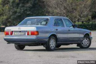

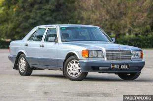

What a difference an engine’s absence makes – would sir like a three-box, or something altogether more slippery? W126 Mercedes-Benz 300 SE (above), You do not have permission to view the full content of this post. Log in or register now. (below)All that said, engine layouts as a defining characteristic of a car may well be on its way into the history books, as the internal combustion engine itself is coming to the end of its road, dictated by looming emissions regulations.
