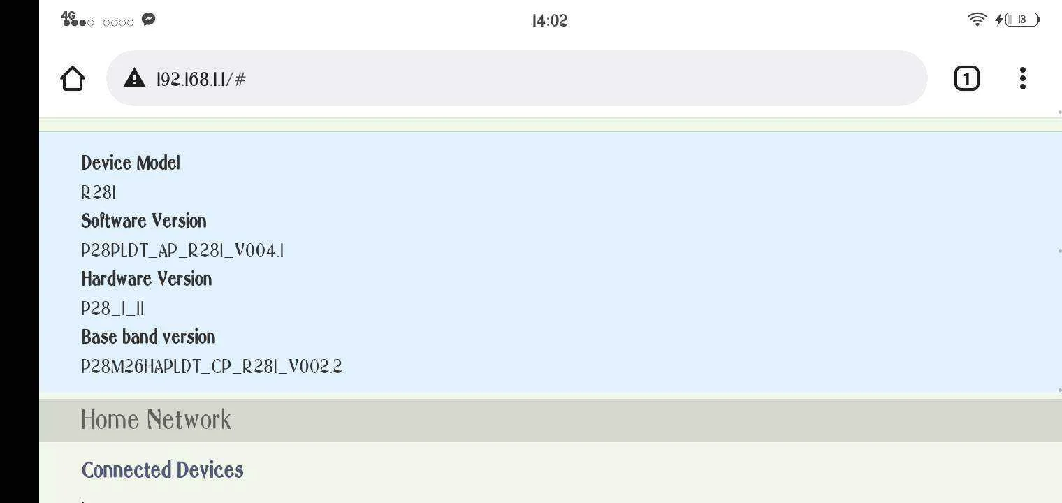

Ano kaya firmware version nyan, Lods. Balitaan mo kami, baka updated din sa version 4.2 at baseband 2.2. Wak mo agad salpak yung sim nya, para inde agad mag auto updates. Baka naka old firmware pa yan, yung V4.0 at baseband 2.0. Pwede yan, madukot firmwares para ma shared mo. Pwede kac unlocked at bandlocking jan pag old firmwares, pero kelangan mo paturo sa mga masters dto kung papaano paganahin ung nginx at shh, para maback up old firmwares, saka pwede rin ma edit firmware para ma disabled auto updates👍👍

paano pala kung latest firmware makuha lods? ibigsabihin..hindi pwede maopenline? o hindi lang pwede maglock band?
Pwede pa lockband, Lods kung firmware v2.2 at baseband 2.2, pwede i disable auto updates mag backread kalang page 26 To page 40 then paturo sa iba na iba d masundan, hanapin mga masters. I download sa page 1 yung band lock

Dalawa pala Gui nyan, Lods. Simula nung mag updates. Pm mo mgq master via private message, Lodi H4wkeye, Master Lenar, oblivion85 cla mga naunang nakasunod pang disabled
pag 4.1 hugot agad hahaha
Inde na pala Pwede maa-unlock Lods kung version 4.2 bandlocking lang pwede, Yung mga naa unlock v4 at v4.1

4.1 2.2 boss poidi kaya openline
