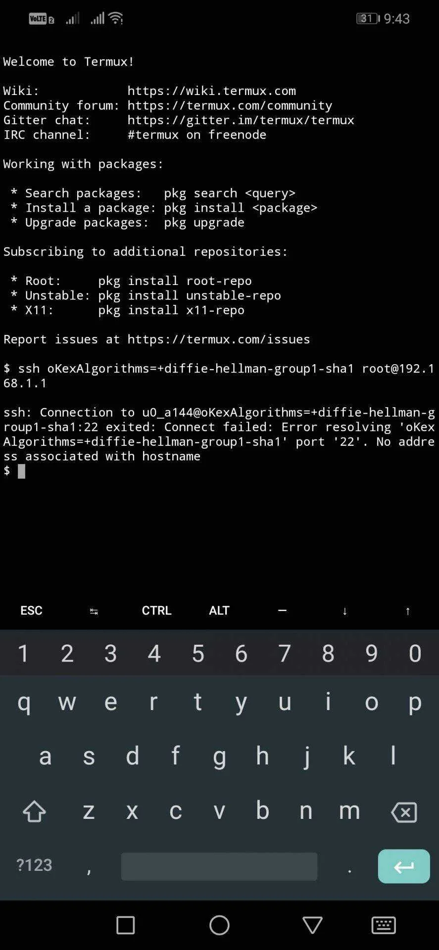

Nagawa ko na pero sablay pa sa session 2Screenshot_20210921_125841_com.termux.webp
Open pa telnet ko ayaw ko iclose
Good this is what you will need to do download telnet app from playstore. Once downloaded access telnet there run ubus call router set_dropbear_info '{"dropbear_mode":"1","dropbear_key_type":"99"}' next passwd create your pw after creating pw run fw_setenv dropbear_password yourpw then run fw_printenv after all this go to termux and try to access ssh make sure clear your data first.

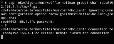

Done na po yan.. ung patapos ng mtd9.gz new session tas entercode lumilitaw password pero d mag tuloy nag cclose connection daw kaya d ma dump ung mtd0-9. Yun ang prob ayaw gumana
