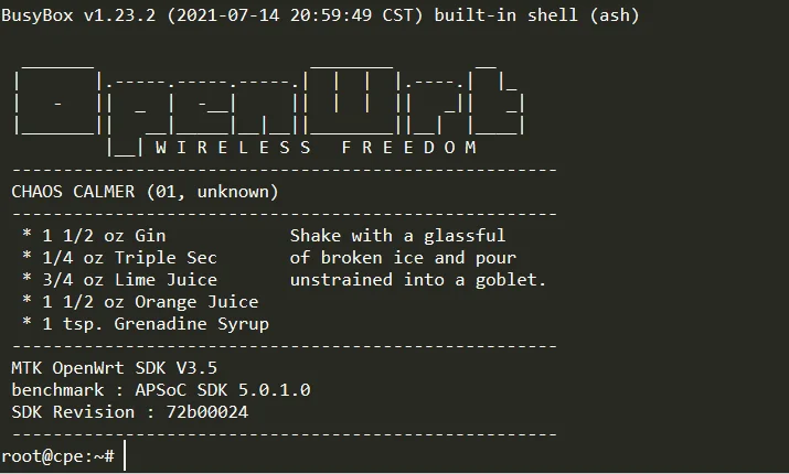

ah okay, backread ka dito 1-3 pages may nilagay ako ditp link pldt version 4.0 na galing kay sir jhowel, flash mo yun via TFTPD method after nun restore mo, at e access ang SSH, username: root pass: notion
2. at dun ka ulit mag change password or no need na. 3. after nun flash ka ulit ng firmware 4.2 or smartbro 5.2 at e restore. 4. Afte nun pwede mo na ulit ma access ang ssh via <?xml version="1.0" encoding="US-ASCII"?> <RGW> <param> <method>call</method> <session>000</session> <obj_path>wireless</obj_path> <obj_method>wifi_ate_enable</obj_method> </param> </RGW>

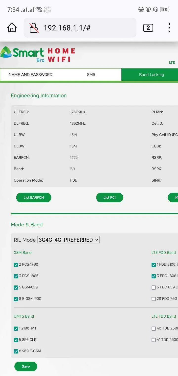

Meron po ba palang way para malock ko Band 28/1? Pag Chineck ko po kasi yung 28 at 1 lang nagiging 1/28 minsan tapos bumabagal
baka mabagal isang band paps, pag gusto mo mag CA dapat pareho stable at mabilis, kung bumabagal lang din naman e single lock band mo na lang.

sad to say, hindi parin lods, sa version 4, may password parin, pano kaya to? after ko mag flash ng 4.0 tapos restore, may pass parin, na try korin password=notion, di po nagwowork
patingin dashboard mo paps kung anong version na, na try mo na bang e restore?
Lods, na access kuna yung telnet no password sa 4.0, need lng pala ulit2x restore, tapos pinalitan ko ulit, ni save ko yung ginawa ko na pass. Gumana sya na try ko logout then login tapos nag flash ulit ako sa 4.2, yung file ni sir jhowel. Ngayon di na ulit gumagana yung pass.

thanks lods, na fix na po, ginamit ko po yung file na send nyo dito previously na v4.2, 9mb lng kasi yung file ni sir jhowel, tapos yung sayo ay 30+ mb, baka wala don yung pang reset ng password.
Thank you lods, na access kona ulit using v4.2
update ko lang sa firmware ni rus&lucas, bumibitaw 'yung bandlock.
ni-lock ko ng single band (41/X) then after ilang oras naging (3/28)
thrice nangyari, akala ko nagloloko modem. Babalik nalang ako sa stable 4.2 fw ni boss jhowel, mas okay bandlock.

Try mo gamit yung smartbro gui 5.2 kapit na kapit daw CA niya sabi ng iba.
mas stable talaga bagong gui nila yan din na pansin ko hindi bumibitaw ang ca kahit naka cell lock pa..
naka lock ako sa band 3 hindi sya nagiging 3/xx
yung list feature nalang talaga di ko mapagana haha
i also tried na eimplement yung www file mo pong shinare sir to 5.2 fw pero ganon din po yung problem. ayaw gumana ni list sir
