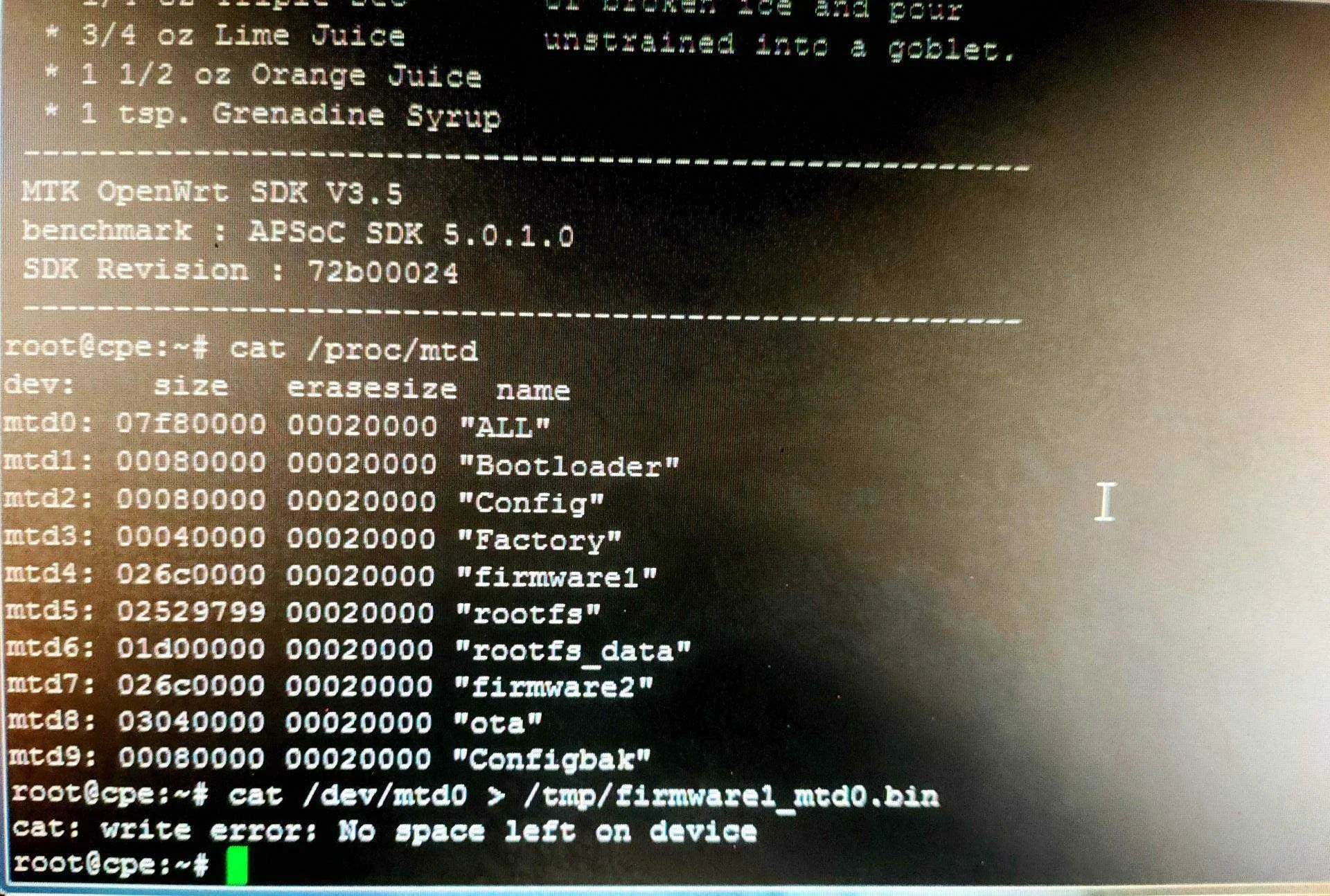

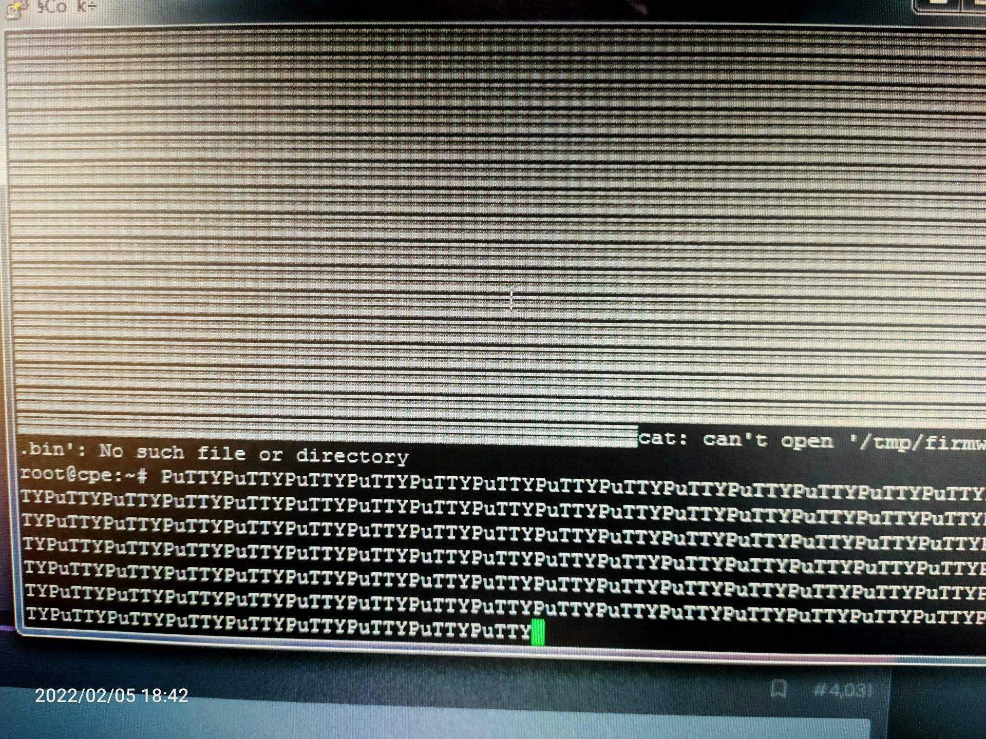

Saan ko makikita back up MTD pano ma transfer sa Windows Lods?
Diba yun kay Impact MTD4? r281_mtd4_4.2 Dapat MTD4 ba Back up ko?
cat /dev/mtd0 /tmp/firmware.bin
Ayaw Gumana nito Lods😆 baka masira to🤣Yung Kay _ameee Working Kaso Wala daw space pwde ba direct sa Windows ko backup?
Sample commands lang yan, Lods.
Reset router kalang para mabura temporary files jan sa tmp folder r281, bale ung kqy impaq gamit ka winscp/mobaxterm kung windows

Pano ko makikita List ng Mtd ko open na ssh ko Ano kelangan Back up yung kay Boss Impact gagamitin ko
cat /dev/mtd{number ng firmware1} > /tmp/firmware1_mtd{number ng firmware1}.bin
To backup mtd4 type in ssh:
cat /dev/mtd4> /tmp/mtd4.bin
Then use winscp, log in using root as username, use the password that you are using when logging in to ssh. In winscp use SCP as the file protocol and use port 22. When already log in browse to tmp directory of your modem, look for mtd4.bin and drag it to your windows directory.
Lods Nagamit ko itong command na ito may pumasok sa tmp folder mtd4 kaso may error no space left daw may way ba na direct windows back up using (cat) or sa Winscp direct Backup Mtd4
Pag Yung Kay Boss Impact Ginamit ko ano dapat back up ko Mtd4 lang Yung ba mapalitan pag apply ko Kay Impact🤔 Permanent unli reset na ba Yun with disable update?
Yes, mtd4 lang yun lang kasi ang papalitan niya. Kasya dapat yan pag mtd4 lang. Tama, yung mtd ni IMPACT2 unli reset na.
Ganito Kasi lumalabas pag backup ako MTD no space baka pwede direct back up sa windows using winscp?🤔
Ito lang ang gamitin mo:
Yan lang ang kailangang i backup
