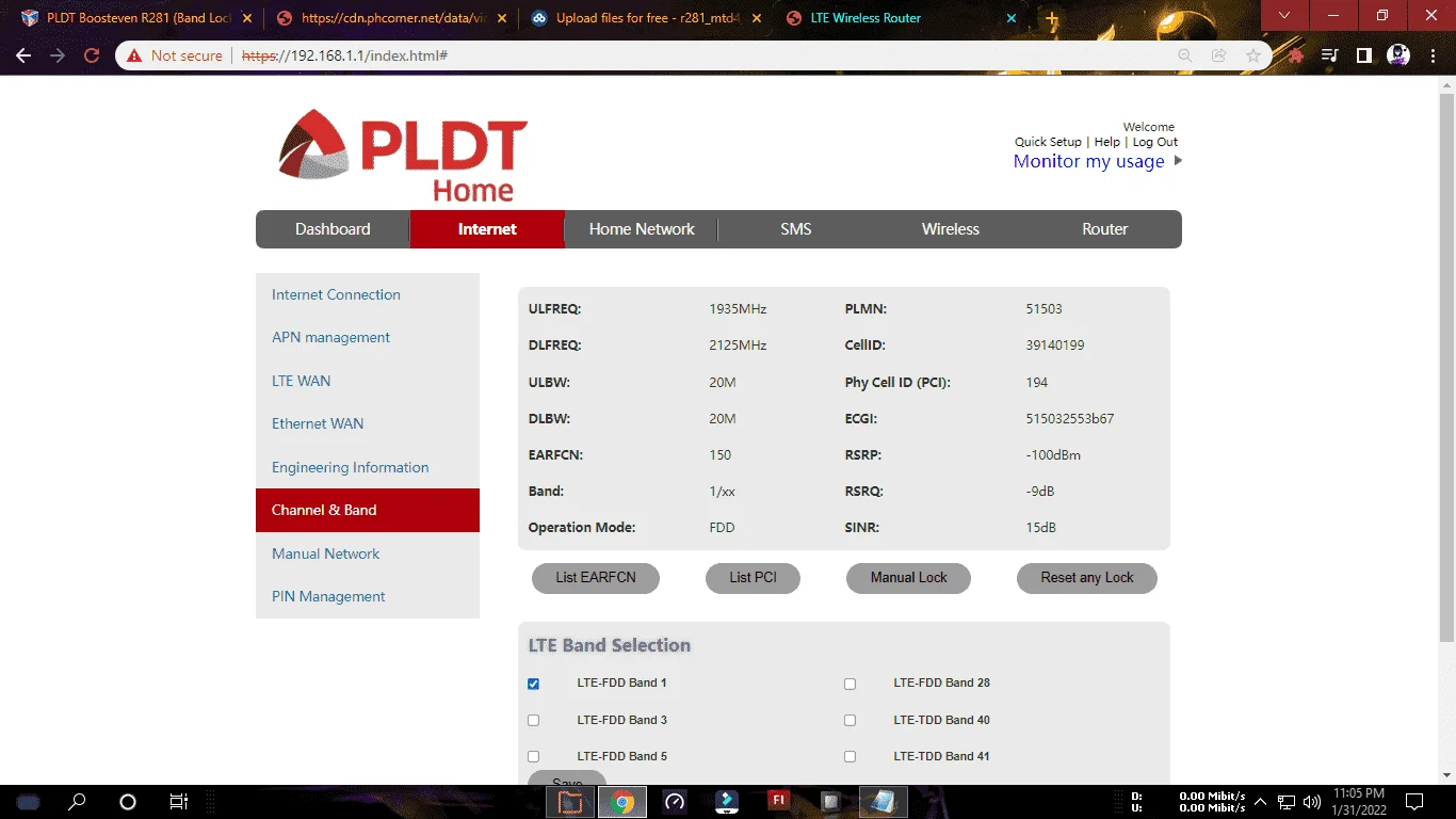

Last question lods, ok lang ba patong agad nitong bagong sysupgrade? nag sysupgrade na kasi ako sa temporary easy bandlocking ni master zxshiels
Mawawala yung kay zxshiels na easy bandlocking, pero mas maganda yung kay IMPACT2, dahil may easy bandlocking from zxshiels, freq lock at Cell ID lock from EugeneKey plus permanent din yung disable updates niya.

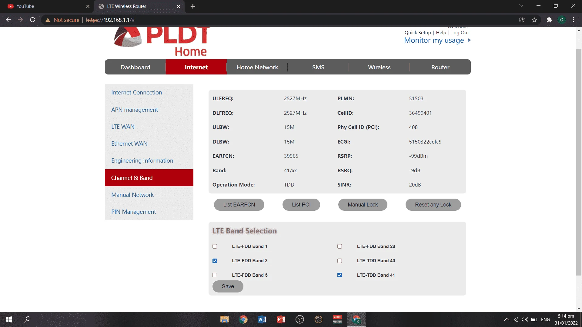

natry ko na iflash using sir gallium8 's method and unlirest nga talaga siya kasi di nawala after soft reset. thank you so much po again master 1MPACT2 and sir gallium8 for being generous po sa aming kaphc. vouch ko nalang din po yung file na safe siya and recommended na rin sa mga nagtitipid. again thank you for keeping the spirit of forum sharing for free mga masters
After flashing and logging in to R281, i-Restore Factory Settings mo para mag stick yung settings mo everytime mag reboot ka ng R281.
