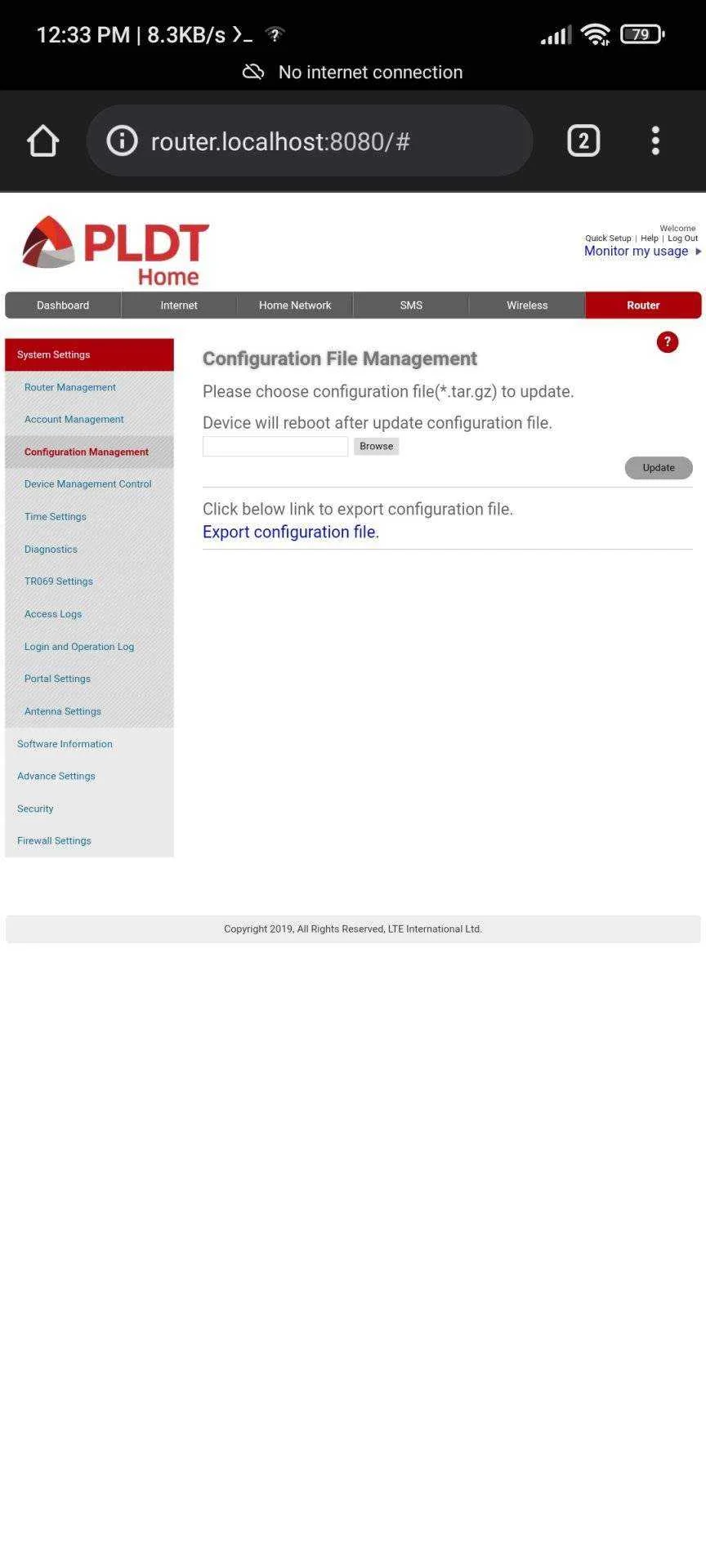

Baka po may config file tar.gz po kayo na may bandlocking po, pa share 🙂 di talaga mastable connection ng r281 sa lugar namin..Screenshot_2022-01-18-12-33-03-628_com.android.chrome.webp
Gawa ka lods share
