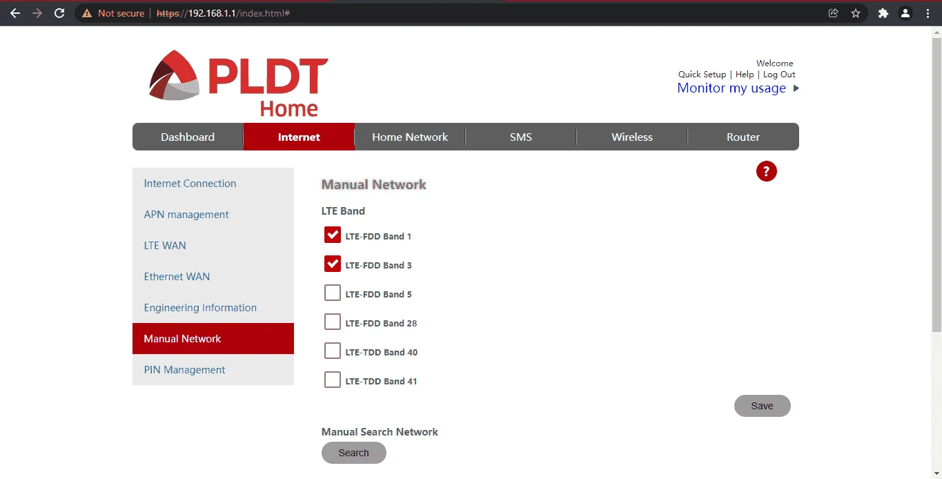

naka bandlock lang ako lods.. nagpapalit plait kac yung 3/28 tsaka 28/3.. buti pa sa d2k may band prioritization.
stable kac yung 3/28
Bigay mo freq number gawin ko ung command.
Band 3/28 first just enable band 3 and band 28 using at+znlockband command then run ubus call cm set_cell_lock command make sure to check your freq number for Band 3 all I know their freq number for smart 1350 or 1775.

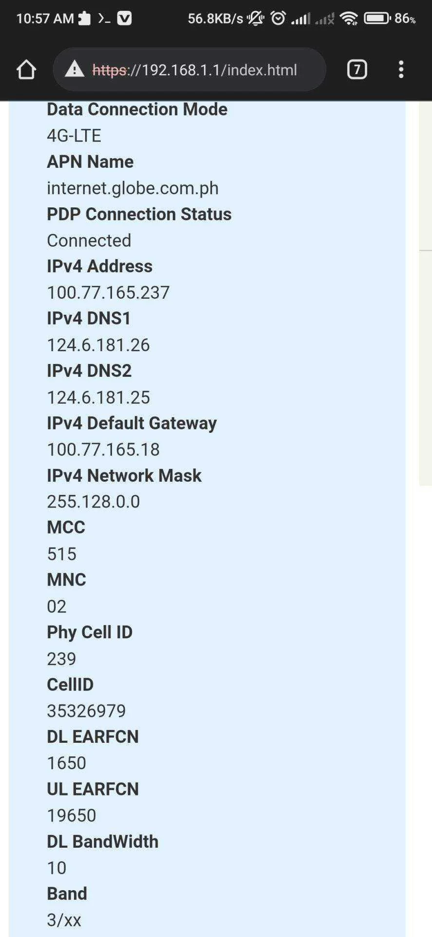

H4wk3ye band 3 earfcn 1650
band 28 earfcn 9305 .. yan po lods
3/28 po dapat lods
sige po lods try ko po itong command
Naka globe or GOMO? Palitan mo lang freq na nilagay ko dun ka lang magpalit ilagay mo yang freq number ng globe.

ganito po lods?
ubus call version set_atcmd_info '{"atcmd":"AT+ZNLOCKBAND=1,0,8000004,0"}'
ubus call cm set_cell_lock '{"mode":"1","act":"3","band":"3","freq":"1650","cellid":"0"}'
ubus call cm set_cell_lock '{"mode":"1","act":"28","band":"28","freq":"9305","cellid":"0"}'
ganito po lods?
Firts at Second lang kung Band 3/28 ang gusto mo. Tapos kapag Band 28/3 first at third command pero ang problema sa Band 28/3 minsan Band 28/xx lang ang lalabas di mabasa CA
ahh, ok po
maraming thank you po
ayaw po mag CA

paturo nman boss paano mo nagawa sa pc
naka enable na ba ssh/telnet mo lodi?
kelangan mo lang winscp at putty or pwde din yung sa windows na cmd prompt lang gamitin mo download mo yung files na shinare ni zxshiels yung You do not have permission to view the full content of this post. Log in or register now. upload mo sa tmp folder gamit winscp tapos open mo na putty tas run mo na etong cmd
ls -1h /tmp/www.tgz
sysupgrade -r /tmp/www.tgz
pero kelangan naka open na ssh/telnet mo pra maka pasok ka sa modem mo gamit winscp at putty.
