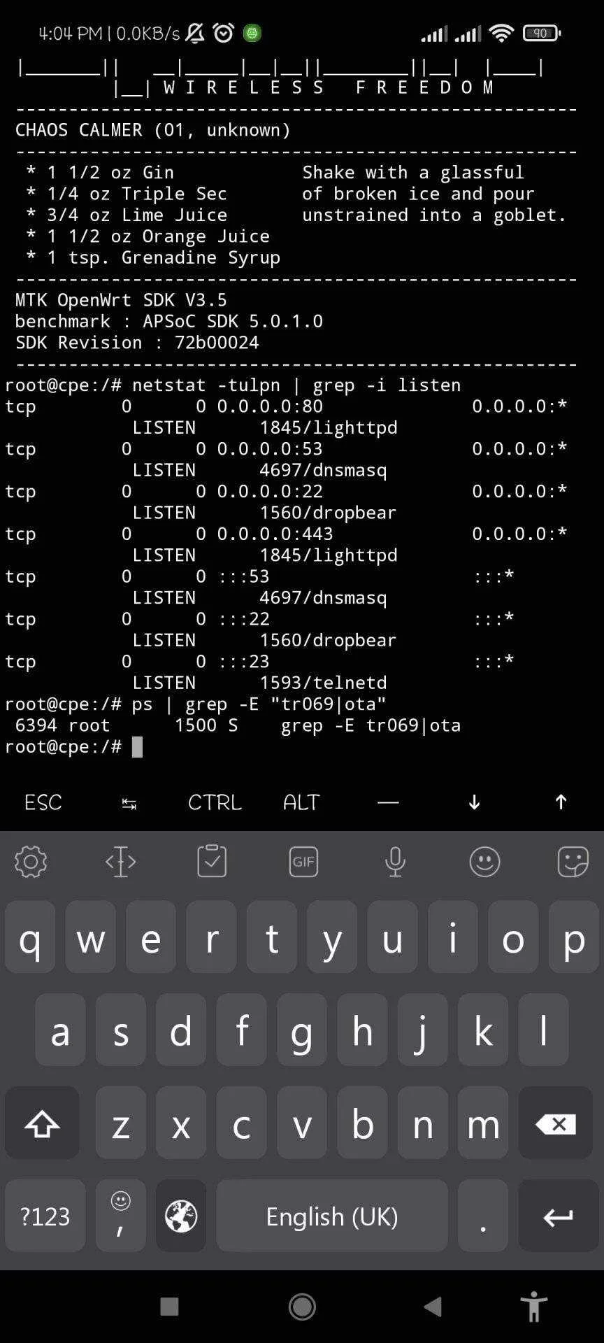

login via telnet/ssh and run all this commands.
Bash:
fw_setenv TR069_INFO "MODEL=P28OPEN;OUI=010203;tr069_enable=0;inform_enable=0;acs_url=http://localhost:9091"
fw_setenv FOTA_INFO "FOTA_ENABLE=0;fota_upgrade_url=http://localhost;fota_register_url=http://localhost"
sed -i 's/\(^.*echo\)\(.*fota_upgrade\)/#\1\2/' /etc/init.d/services.init
sed -i 's/\(^.*start_instance\)\(.*ota\)/#\1\2/' /etc/init.d/services.init
sed -i 's/\(^.*start_instance\)\(.*tr069\)/#\1\2/' /etc/init.d/services.init
# Huwag niyo na irun to reboot niyo nalang router niyo.
# /etc/init.d/services.init restart
Then confirm natin kung gumana mga commands.
Bash:
netstat -tulpn | grep -i listen
# dapat wala kayong makitang tr069
ps | grep -E "tr069|ota"
# dapat wala kayong makitang usr/bin/ota o usr/bin/tr069
Na try ko code lods tama ba?
