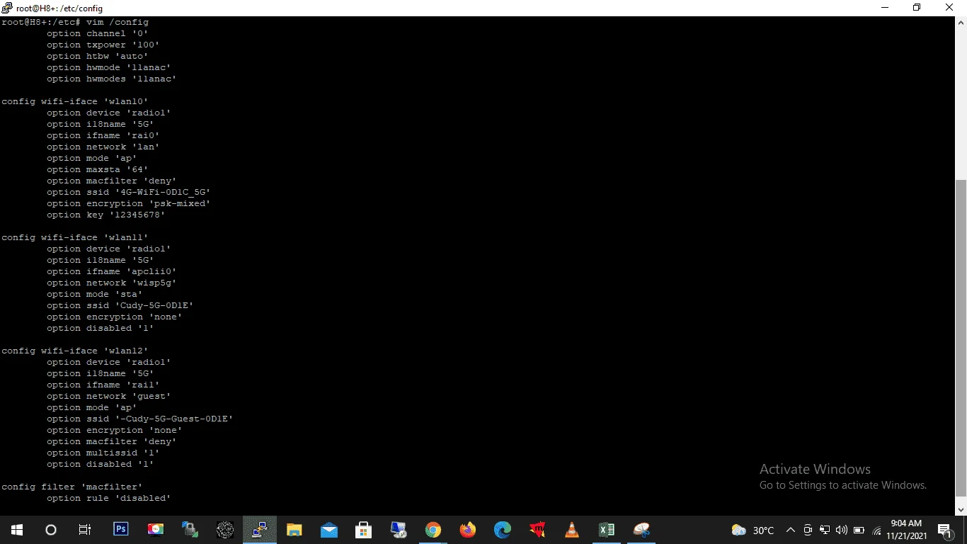

Diko mahanap lods wala kasi akong ganyan na modem. Pa run naman
Code:
uci show configs
ito lods
Code:
cat /etc/config/wireless
Code:
 LEDE 17.01.5, 1.0.28
root@H8+:~# cat /etc/config/wireless
config wifi-device 'radio0'
        option type 'mt7628'
        option country 'CN'
        option channel '0'
        option txpower '100'
        option htbw 'auto'
        option hwmode '11bgn'
        option hwmodes '11bgn'
        option default '0'
config wifi-iface 'wlan00'
        option device 'radio0'
        option i18name '2.4G'
        option ifname 'ra0'
        option network 'lan'
        option mode 'ap'
        option maxsta '64'
        option macfilter 'deny'
        option encryption 'psk-mixed'
        option ssid 'wafi'
        option key '1026Jay@'
        option hidden '1'
config wifi-iface 'wlan01'
        option ifname 'apcli0'
        option network 'wisp'
        option mode 'sta'
        option ssid 'Cudy-0D1C'
        option encryption 'none'
        option disabled '1'
config wifi-iface 'wlan02'
        option ifname 'ra1'
        option network 'guest'
        option mode 'ap'
        option ssid '-Cudy-Guest-0D1C'
        option multissid '1'
        option disabled '1'
config wifi-device 'radio1'
        option type 'mt7612e'
        option country 'CN'
        option channel '0'
        option htbw 'auto'
        option hwmode '11anac'
        option hwmodes '11anac'
config wifi-iface 'wlan10'
        option device 'radio1'
        option i18name '5G'
        option ifname 'rai0'
        option mode 'ap'
        option maxsta '64'
        option ssid '4G-WiFi-0D1C_5G'
        option key '12345678'
config wifi-iface 'wlan11'
        option i18name '5G'
        option ifname 'apclii0'
        option network 'wisp5g'
        option mode 'sta'
        option ssid 'Cudy-5G-0D1E'
        option disabled '1'
config wifi-iface 'wlan12'
        option i18name '5G'
        option ifname 'rai1'
        option mode 'ap'
        option ssid '-Cudy-5G-Guest-0D1E'
        option disabled '1'
config filter 'macfilter'
        option rule 'disabled'
root@H8+:~#
ito lods
Code:
        option country 'CN'
        option channel '0'
        option htbw 'auto'
        option default '0'
        option ifname 'ra0'
        option mode 'ap'
        option maxsta '64'
        option ssid 'wafi'
        option hidden '1'
        option mode 'sta'
        option disabled '1'
        option ifname 'ra1'
        option mode 'ap'
        option disabled '1'
        option country 'CN'
        option channel '0'
        option htbw 'auto'
        option i18name '5G'
        option mode 'ap'
        option maxsta '64'
        option i18name '5G'
        option mode 'sta'
        option disabled '1'
        option i18name '5G'
        option mode 'ap'
        option disabled '1'
root@H8+:~#
Wala bang superadmin yan lods? Diko kasi mahanap at wala akong ganyan na modem. Pa cnxia na
Lock lte band sa file ni Master LENAR not working. Kahit try mo saka sa fw ako nag edit.
Check anong mga command ang available sa ubus run mo. ubus -S list or ubus -v list Screen shot mo sakin para makita natin syntax ng command
Guyz may nag email sakin may openline na daw ang R281 v4.2 b2.2 pero diko alam kung paano. Mismong taga Smart daw ang gumagawa.
Yes lods run ka lang cell id locking command using at cell.
Meron nan talaga openline yan. Ayaw lang nila ibigay. Cguro napansin na nila humina sales ng mga prepaid wifi nila. Hintay hintay lang tayo, bka sa december ibigay na nila yan. Total magpapasko naman. Para lahat happy... 😊😊😊
