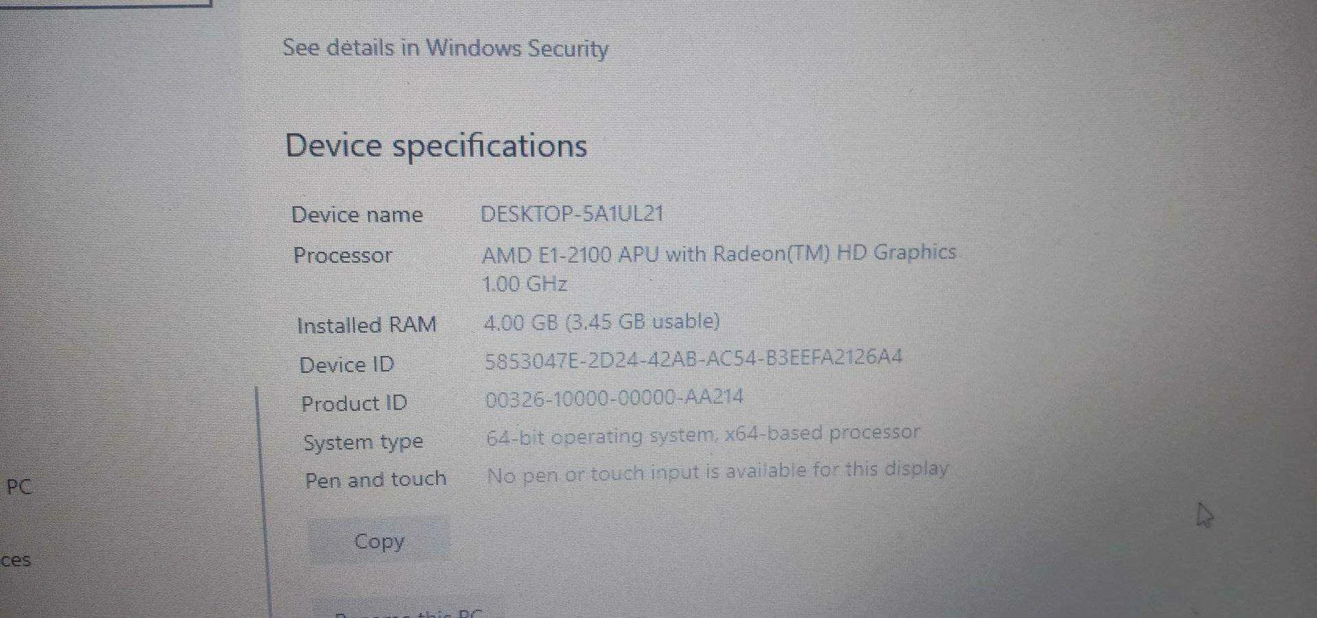

IMG_20210824_183505.webpHelp din po, sobrang lag din po kasi gamitin sana for online class. Pwede po ba sya iupgrade into ssd? The magkano po kaya magagastos kung sakali?

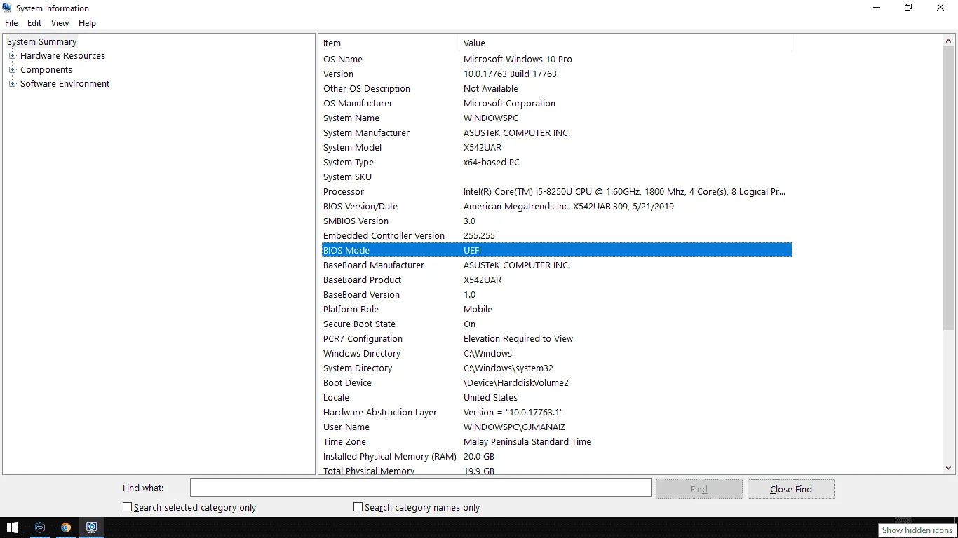

this is a very common issues on the pre installed laptops, naka UEFI Boot kasi sila, all my laptop naka legacy mode at naka MOD os WIN10 Lite RS5 version, very smoth, 1sec lang ang boot-up... try nyu mag tweak sa mga PC nyu explorex2 pag my time
