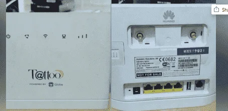

Ah sige boss try ko. no need to use lan cable nato? basta ma-extend lang range ng wifi. may napanood ako sa youtube using globe r01 secondary router. I have extra wifi here, globe ro1, pocket wifi at extra 936.

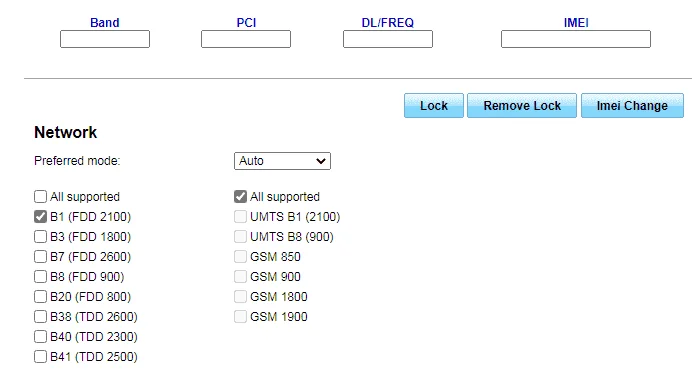

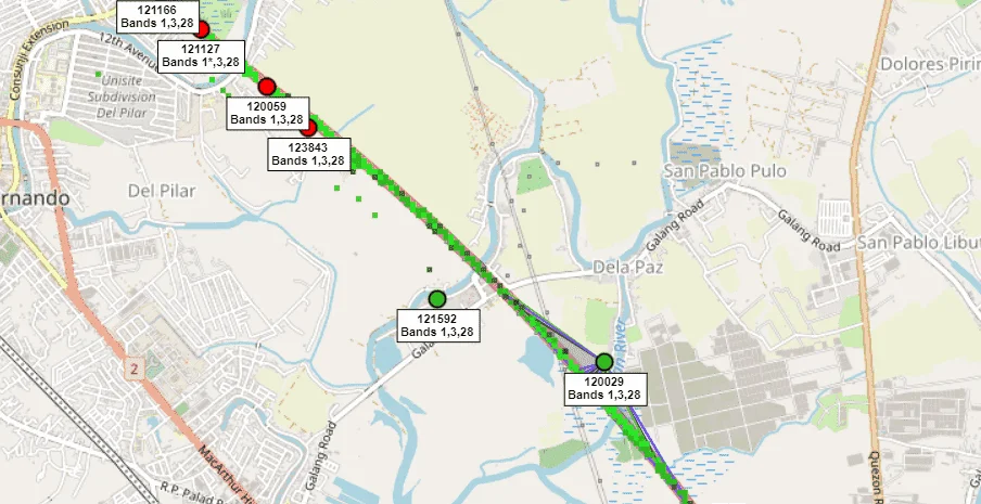

Ok boss nakito ko in siya sa shopee. Paano pala malalaman kung saang cell site naka-connect ang 936? at paano din malalaman if congested yung cell tower? Biglang bumilis net ko now i-cell lock ko sana kaso diko alam paano e kahit may cell locking yung 936 ko. 1627862423244.webp1627862375167.png1627862348573.png
