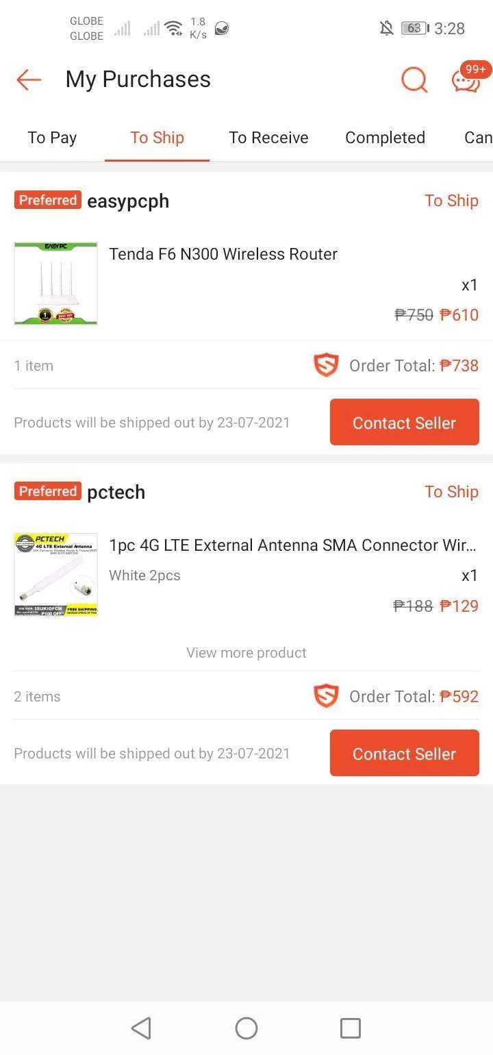

May ibang wifi receiver/repeater ba na pwedeng pampalit? Or maybe a receiver but more like router? Screenshot_20210720_203857_com.shopee.ph.webp

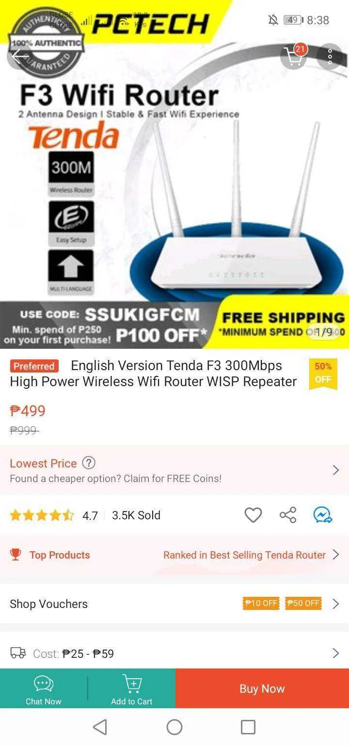

I'm thinking about this one po. May thread kasi ako before and one of the ka phc suggested this. Now idk if this will work kasi yung wifi rental nya is unencrypted ssid but u need a voucher for it once you entered his hotspot.fast portal nya. Baka kasi magaya lang sa xiaomi wifi repeater pro, no internet access.
Baka Access Point na po need nyo? Kung madaming interference sa area nyo, possible talaga na nagd-dc.
Pero kung yung pocket Wi-Fi ay kaya naman po. Tingin ko yang bibilhin nyo ay kaya din po.

Since the globe pocket wifi worked maybe i don't need to spend on more expensive stuff? Or yung tenda f6(baka mas malakas to since higher level) 😂
