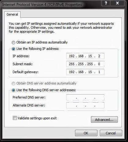

I. set static ip
IP add: 192.168.15.2
Sub mask: 255.255.255.0
gateway: 192.168.15.1

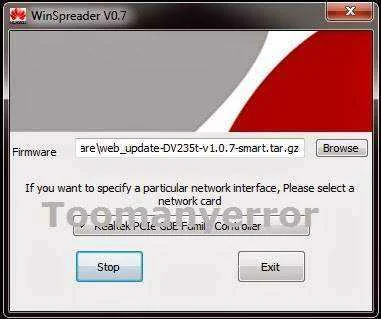

II. plug utp/lan ng dv
open winspreader set all fw and lan card then start
III. plug power adaptor oras'an mo ng 1 minute
IV. after 1 minute remove utp/lan wire then wait 1 minute again
V. after 1 minute remove power adaptor wait 1minute again
VI. after 1 min. plug utp/lan wire and power adaptor
VII. wait 45 secs. iilaw lahat at mapapansin mo yung ilaw ng modem mo patay sindi ng 2 secs. interval ang led(pag ganayan ok na modem mo nag fla flash na sya,hintayin mo hangang mag steady lahat ng ilaw,kung wala wifi led lang umi ilaw back step I)
That's all!
