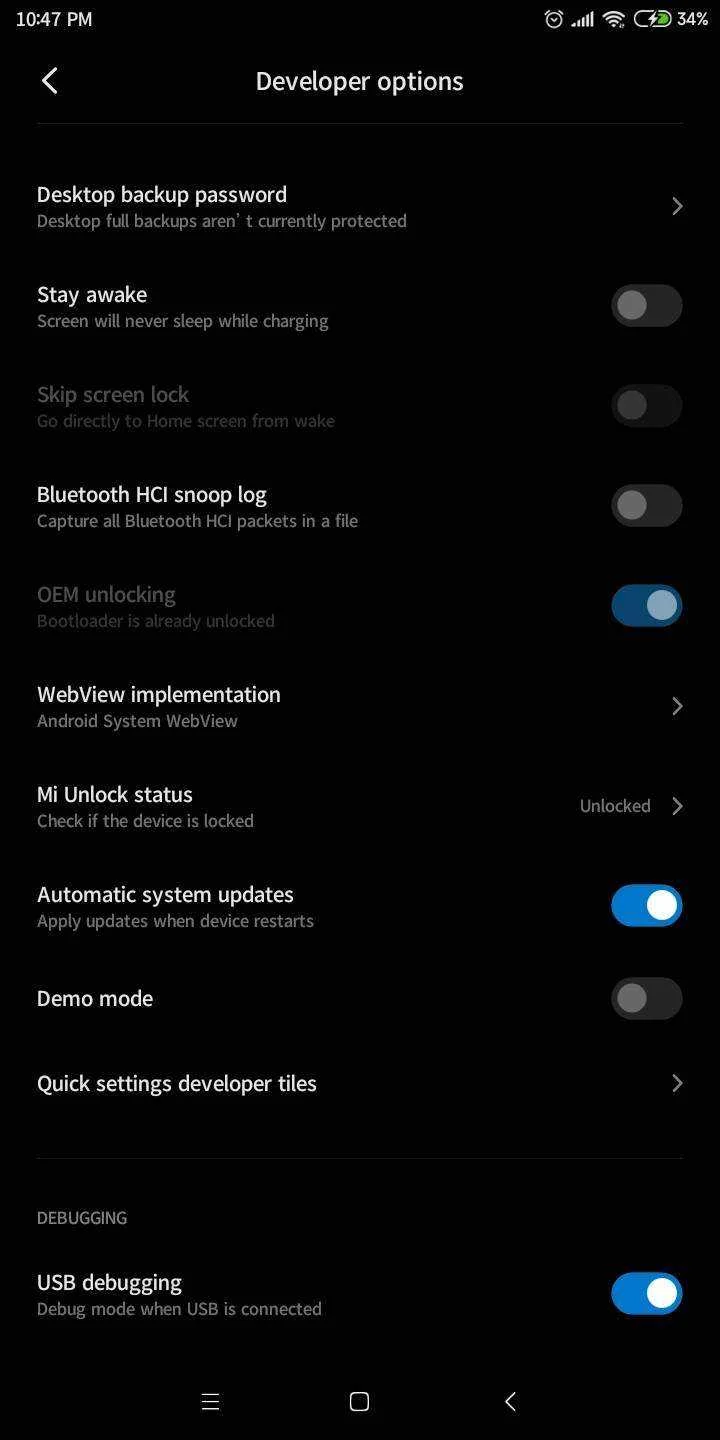

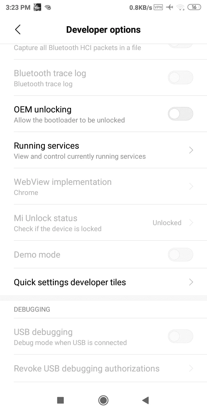

IN THE OPTION DEVELOPER PART:
1. Activate "USB Debugging". 2. Activate "OEM Unlocking" (if there are options).
3. Open Mi Unlock Status> Add account & device.

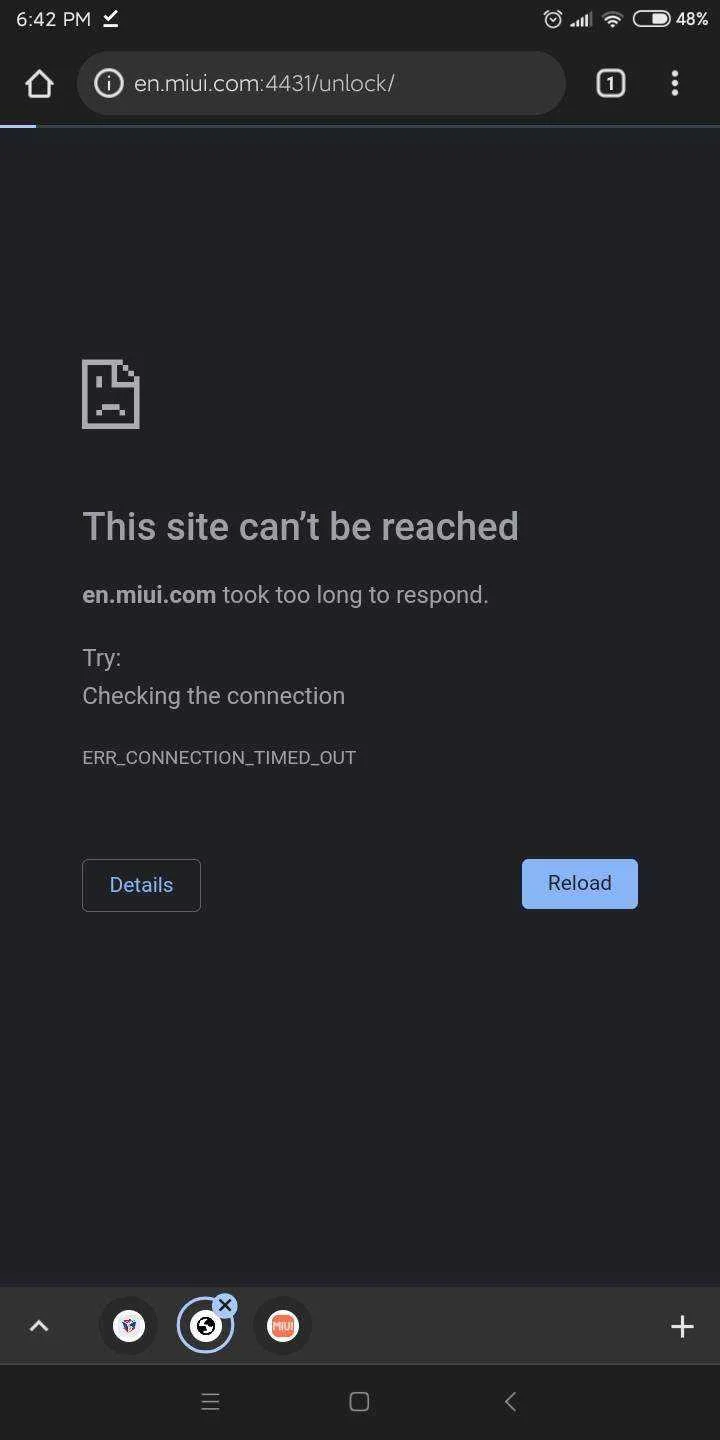

# For those who have errors / stuck at 86016/86012/86006/86010, the solution is to replace the ROM first to MIUI China Dev
REQUEST UNLOCK BOOTLOADER:
1. Open the following address: You do not have permission to view the full content of this post. Log in or register now.
