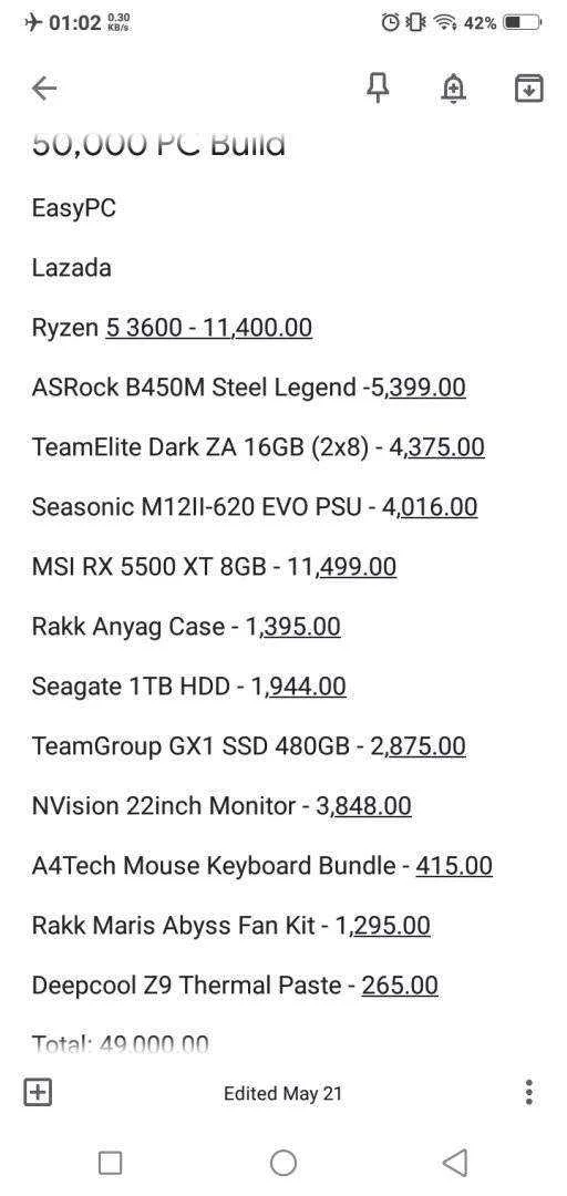

Mga paps any suggestion sa pag build ng own pc. Mga dapat iconsider na hardwares, rams, o bili nalang ba ng buong cpu, etc. yung good for gaming or work related sana. 50k budget. Novice lang ako about dito more on laptop kasi. Salamat.
Yup. I would do the same thing, but make sure you do extensive research so you can get a good bargain👍

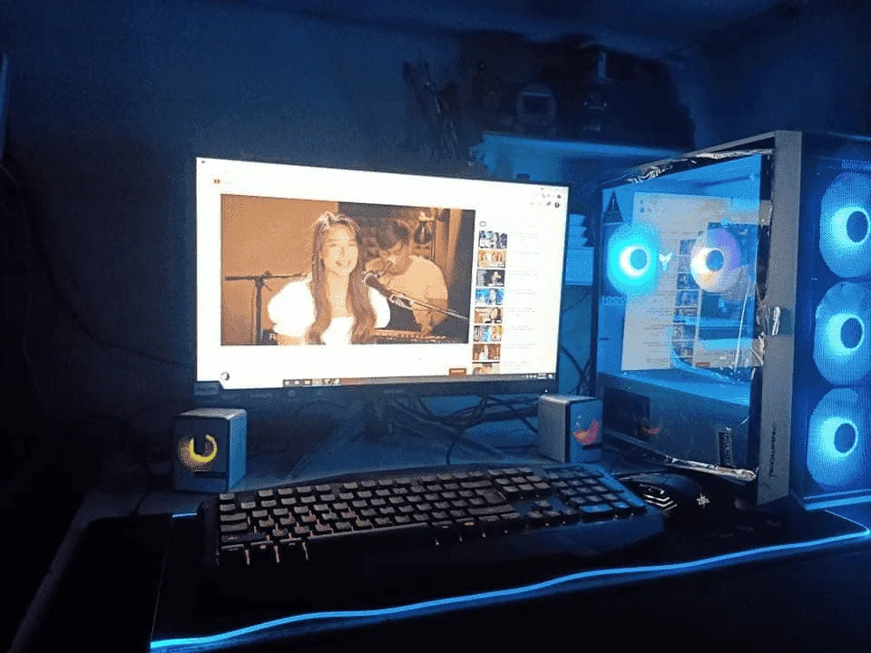

For Reference sir. Recent na nagpabuild sakin last weekend for Rendering and Interior Design. Parts were bought individually mostly sa online shops since Central Luzon kami.
Ung ibang items madaling kunin problem lang is VideoCard. Ang daming Overpriced.

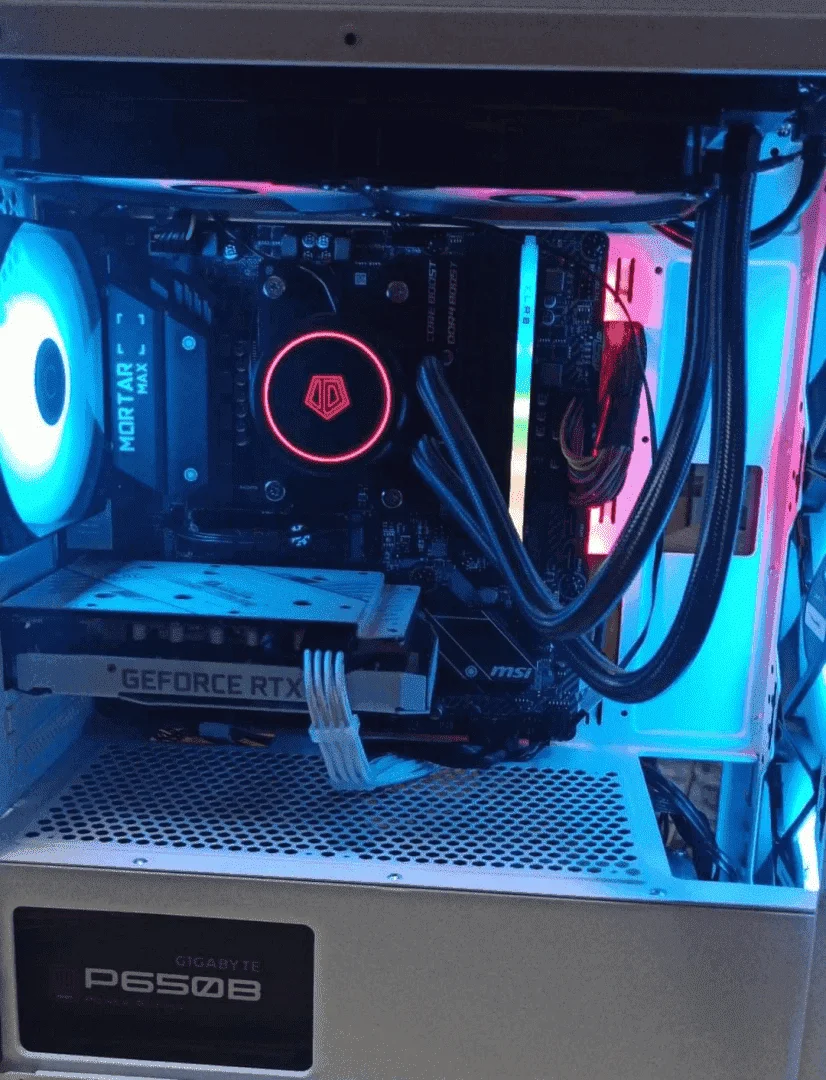

PROCESSOR: ryzen 5 3600 Tray Type with MOTHERBOARD: B450M Mortar Max = 13, 800
RAM: PNY XLR8 Dual Kit 2x 8GB 3200mhz 4550
SSD: Adata XPG SX8200 Pro 512GB PCIE M.2 NVME 3650
HDD: Seagate Barracuda 1TB 2150
PSU: Gigabyte P650B 80+ BRONZE 2850
CASE: TECWARE FORGE M2 with 4 argb fans = 2700
AIO: ID COOLING FROSTFLOW =2800
GPU: NVIDIA RTX 2060 WHITE = 24,000 (2nd Hand)
Sadly Defective nabili nyang AIO. Pinahiram ko muna Air cooler.
