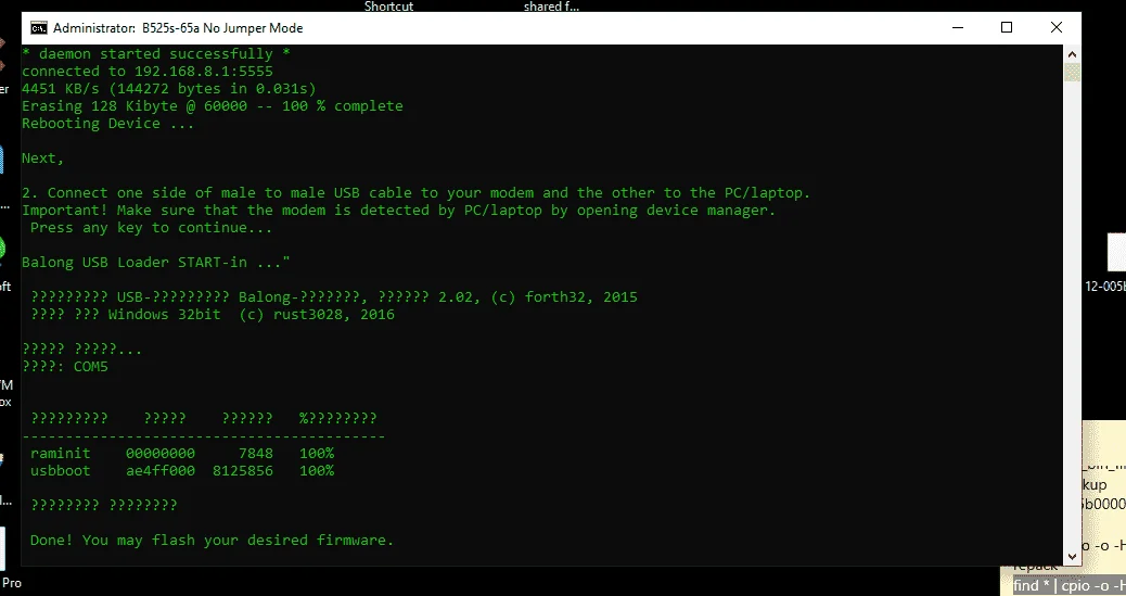

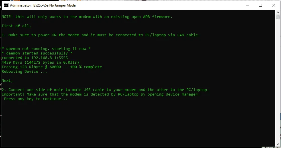

2. Connect niyo na ang modem sa PC/Laptop via LAN cable at male-to-male cable. Then run “1. B525s-65a USB loader (JUMPER MODE NOT REQUIRED).exe”​
1.PNG​

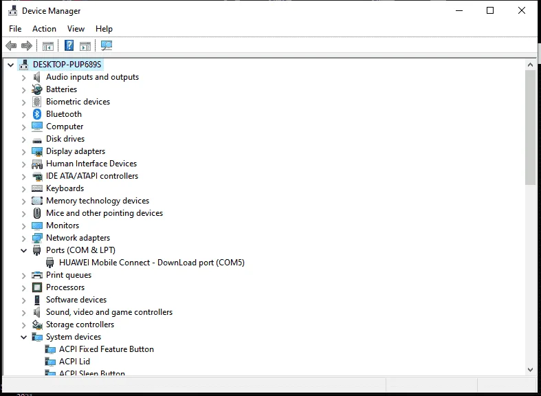

3. Open niyo “Device manager” ng PC/Laptop niyo. Make sure na visible si “Download Port”. Pagkatapos press any key.​
2a.PNG​

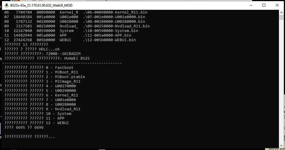

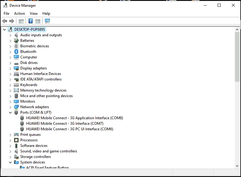

5. Balik ulit sa device manager. Dapat visible na si “3G Application Interface”, 3G Interface”, at “PC UI Interface”. Pag visible na ang tatlong COM port, pwede niyo nang iinstall yung desired niyo na firmware.​
2b.PNG​
3.PNG​
4.PNG​
Credit to all respective owner ng software (at ng code), lalo na kay sir skymatrix, sir jeromelaliagg, at sir jhowel22 .​
make sure po na visible na yung tatlong 3g sa device manager bago magflash ng firmware.
