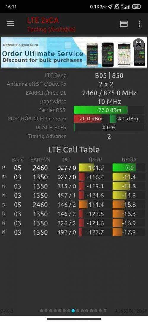

To do this, you need a rooted android device with installed Network Signal Guru
Open Network Signal Guru and make lock to you band what you need. You can test and find the best variant in router or router external antenna location.
For me I found best variant speed and signal with this params:
Band 5
EARCN 2460
PCI 027
Band 3
EARCN 1350
PCI 027

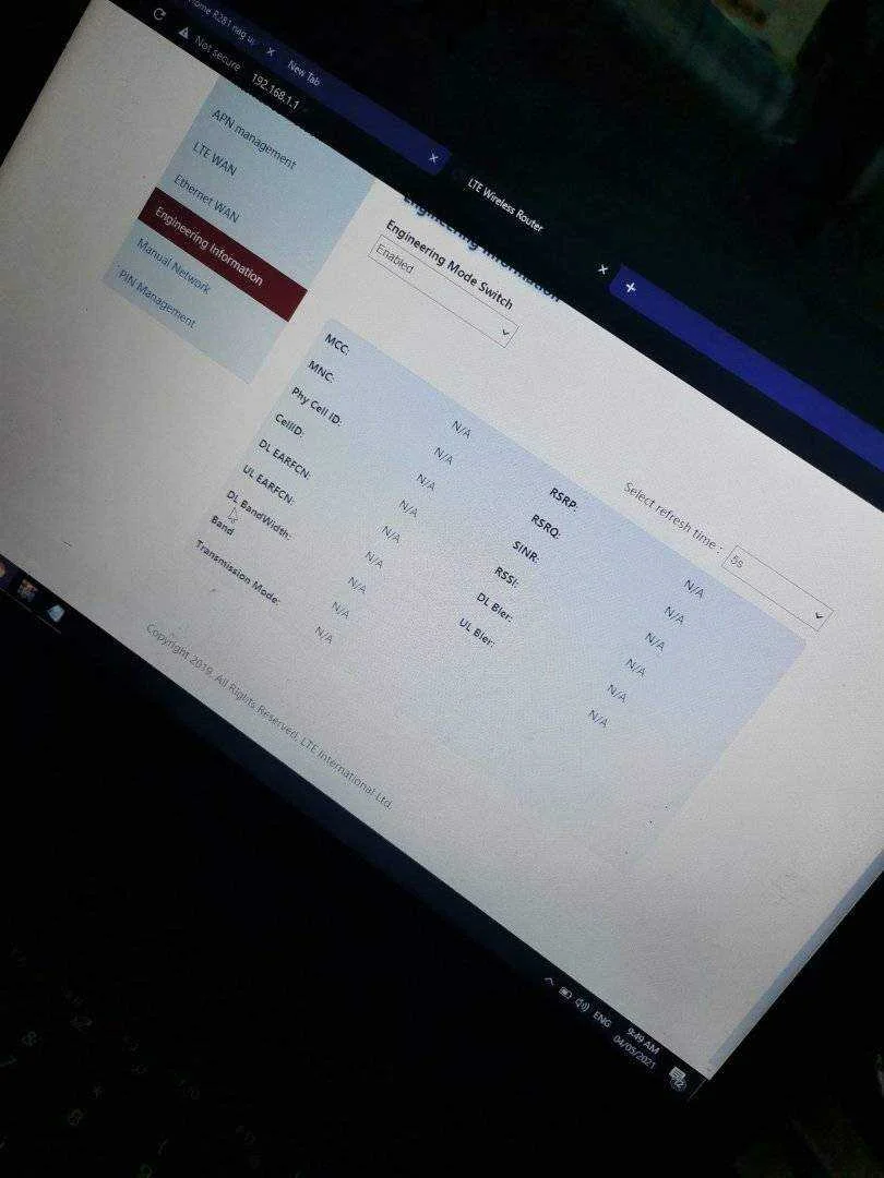

Then connect to microUSB cable to router with installed drivers and try to open admin UI on You do not have permission to view the full content of this post. Log in or register now.

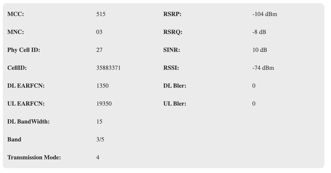

After reboot connect to WiFi and open AdminUI and check connection.
For me it work as expected:
