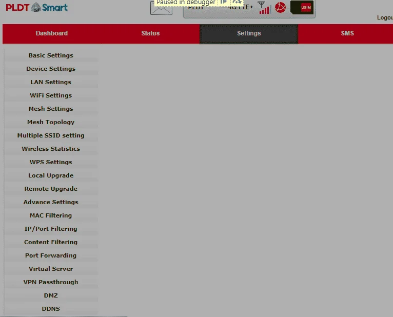

Nag work naman lods gamit yung method ni Master Zander. Ang tanong ko ko lang eh kung pwede kayang mapagana yang mga menu sa taas gamit yung standard pldthome account

Paano kaya mag lock ng band at hindi na maging auto
login ka via admin access
Meron na jan sa taas admin access
Para magawa normal login ka muna via 192.168.1.1
Then login ka via admin access
Type 192.168.1.1/login1.asp
Tapos admin access username and pass by Madam Zander
tingin kung may b28 management dunka mag bandlock
Na try ko na po sir..kaso automatic parin sir. Kahit nalock na po sa band 3 and 40 ..lumilipat parin po sa band 28/3
Kung meron po sana cell id locking sir . Mas madali
