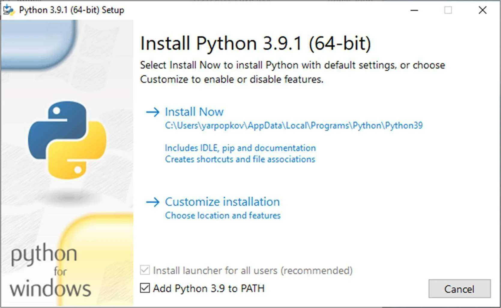

3. Run and install python: python-3.9.1-amd64.exe.
Keep attention: You need to select "Add Python to PATH" before starting the installation.
4. Open cmd or powershell and execute this command:
pip install pyusb pyserial json5

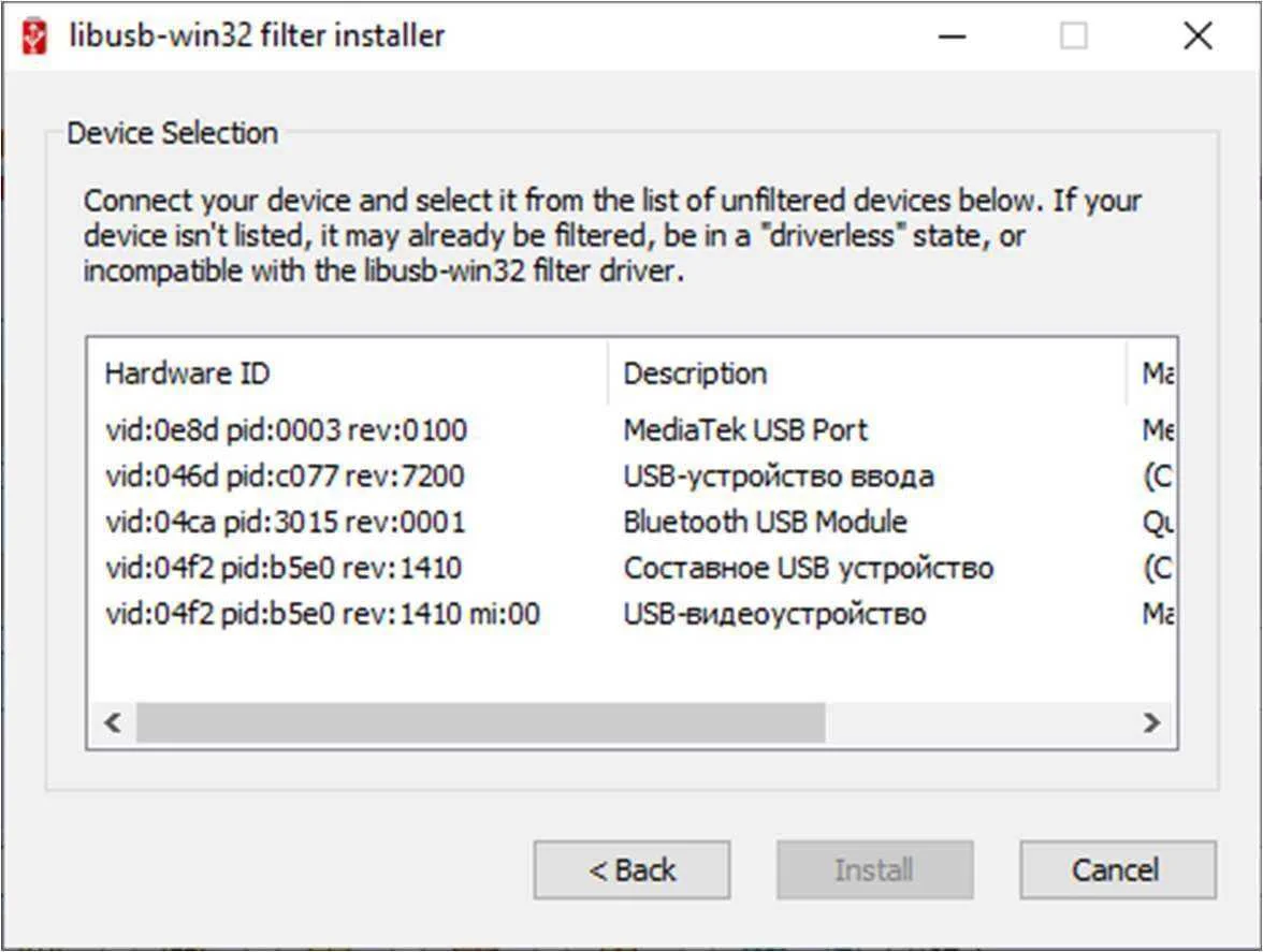

6. Run and install filter wizard: libusb-win32-devel-filter-1.2.6.0.exe.
7. Launch filter wizard.
8. Select Install a device filter and click Next.
9. Connect powered off phone with volume- button to boot in EDL mode.
10. Once you see new MediaTek USB Port in the list, select it and click Install.
Now, you are ready for bypassing EDL !

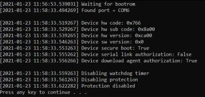

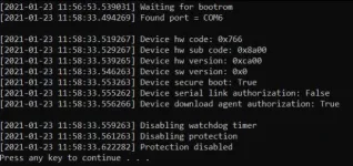

How to bypass:
1. Go to the Bypass folder. Run the script: bypass.bat.
2. Connect powered off phone with volume- button to boot in EDL mode.
3. Once you get "Protection disabled" at the end, without disconnecting phone and usb, run SP Flash Tool

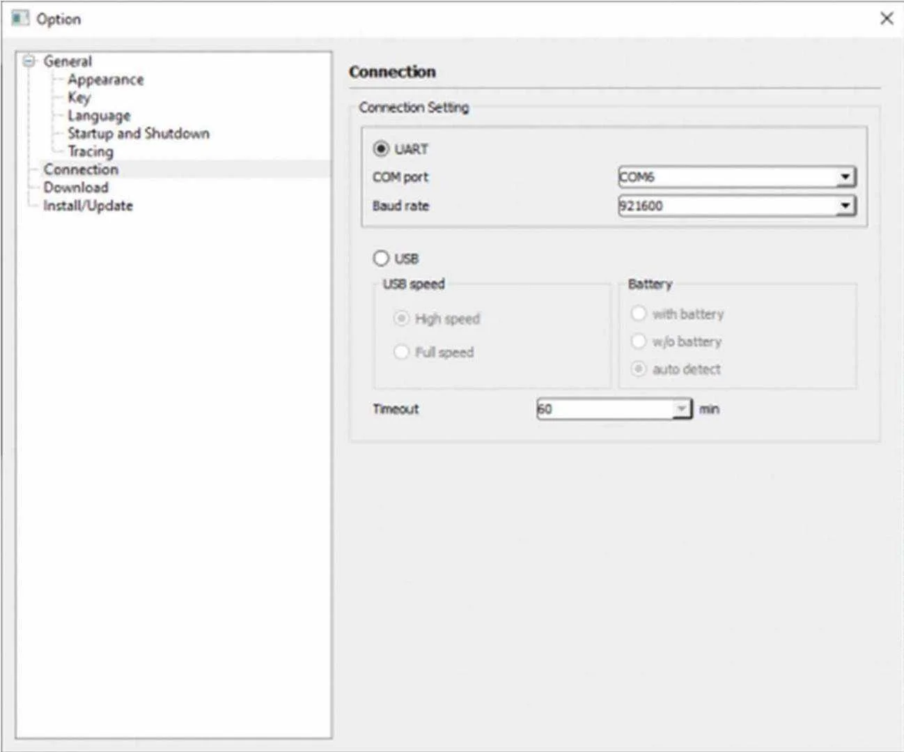

4. Once the SP Flash Tool opens, click Options > Options > Connection.
5. Select UART mode and select Baud rate to 921600.
Now, you are ready for flashing.
