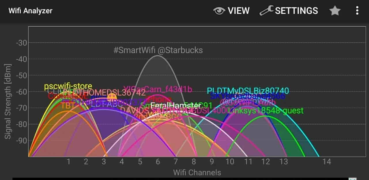

To give you a clearer picture of what I mean about competing frequencies, take a look at these images – I used Wifi Analyzer on Android available for download here

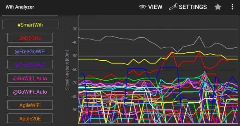

Graph below is based on 2.4G, see how may other wifi you need to comete with? most of them on same channels 1, 5,6,11, 13. What you want to do is stay away from the competition and get a clear crisp signal.

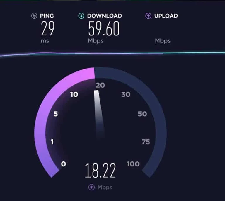

This is just another view of the item above based on a time graph and signal pushed out at fixed intervals.

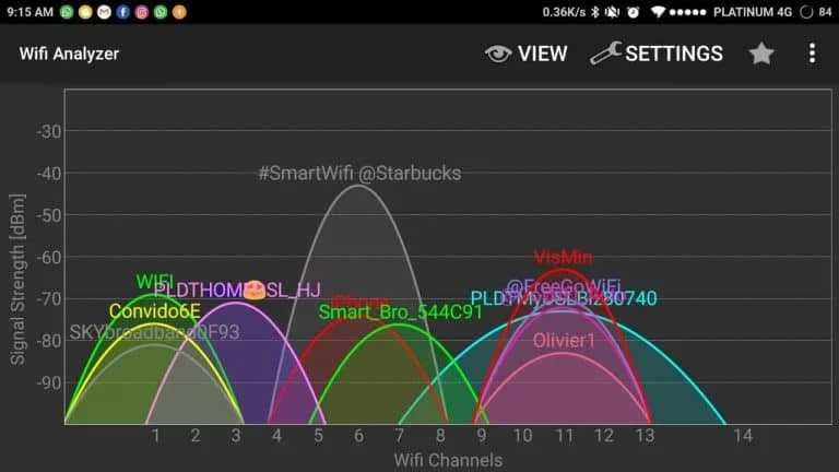

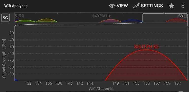

Here is view of the 5G Spectrum. Less Crowded than the 2.4G and faster too.. but signals cramming up in Channel 1,6, 7, 11. The optimal setting is to study the options that your pocket wifi can do.
So here is the ideal setting.. stay away from the pack.. less noise, less competition faster speed with an optimized wifi signal.

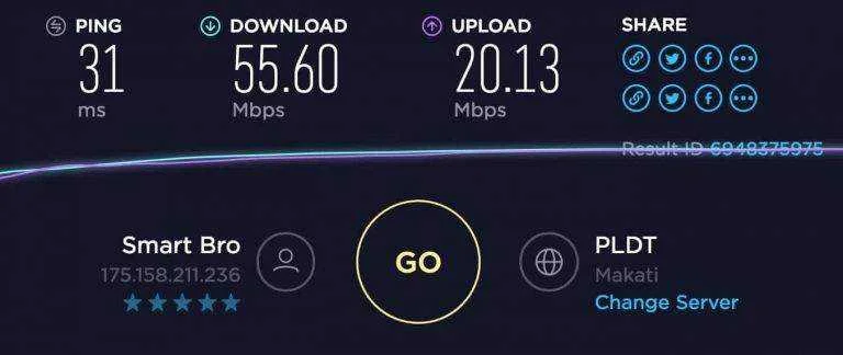

Taken this morning
Gives you fast and consistent signal all the time.

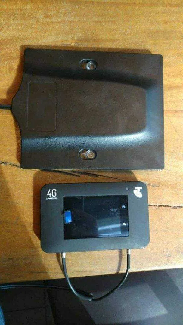

3. Use give your pocket some loving.. boost the signal so it can give you better speeds. There are so many available in Lazada but.. not all will work for you, make sure you get the compatible one for your pocket wifi.
This is my setup.. this is the stock antenna for the netgear aircard 790s, there are others that are stronger just make sure you check the db strength.

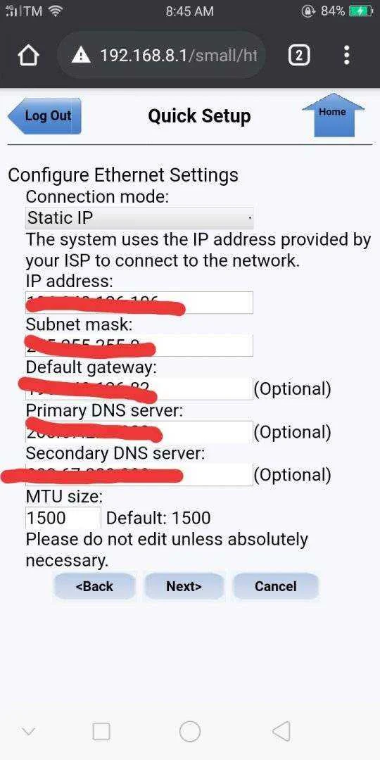

4. Update your DNS and connect faster!
“OpenDNS, Google DNS reduce the time taken to resolve the domain name on the web and make the internet faster in the process. Obviously, it won’t increase the maximum available bandwidth for your connection.” – fossbytes
To use OpenDNS, enter 208.67.222.222 and 208.67.220.220; to use Google DNS, enter 8.8.8.8 and 8.8.4.4.

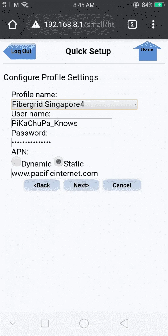

SORI MGA LODI! NAIWAN YUNG SCREENSHOT 😂
Maya naman yung "How to set up APN and DNS Configuration Settings for HUAWEI Pocket WI-FI" 😍
Screenshot_2021-04-02-08-45-32-13.png​
