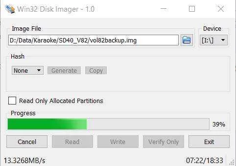

Na backup ko na working, mahapdi lang gagawin. Kaso hanggang backup lang di pwede load ng bagong volume, sample may bagong labas di pwede, or copy ka sa ibang sd card.
Items needed.
1. Pcie card reader
2. Linux system
3. Sd card samsng evo manufature date(2011 to 2016) -sakto meron ako.
4. File pang copy ng sd card ID.
Steps.
1. Check id of origninal card
(Pcie card reader using linux command)
2. Take note nung id (isulat)
3. Ilagay yung samsng sd card.
4. Change id ng samsng gamit yung id ng original.
5. Manual copy ng files to samsng sd card. (Verified working).
Kung may makapag share ng new volume, need rin ng ID ng sd card. Tas need ng samsng na sd card manufactured 2011 to 2016. (Reference google how to clone sd card of satallite receiver)
