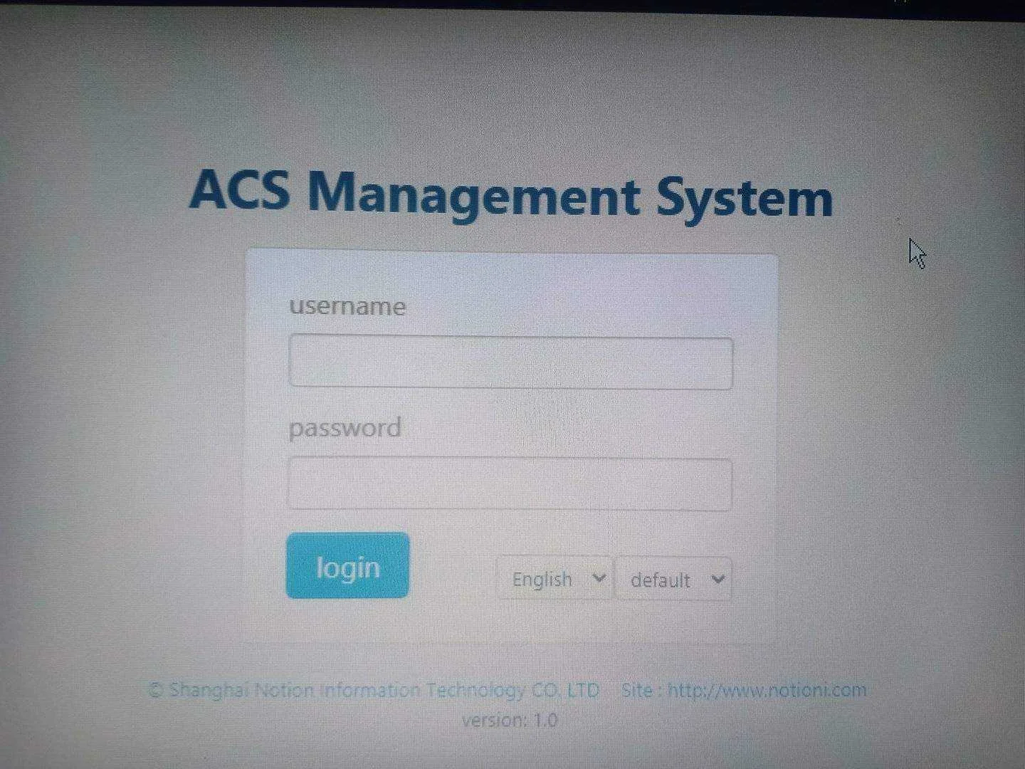

❓ Help PLDT Home R281 nag update ng Software Version (v004.1). Openline di na gumagana.
Nag update ang PLDT Home R281 and hindi na gumagana yung openline na AT+CLCK="PN",0,123456,16
Error na ang nakalagay.
Also, openline na sana ako kaso after the update RED na ang signal. Kaya nag system restore ako planning na i-openline ulit kaso error na yung AT+CLCK="PN",0,123456,16
Any solution?
[XX='EugeneKey, c: 1275133, m: 1668473'][/XX] Unable to sir. And when using putty it show an error message, "Network Error: Connection Refused". I tried researching this error, so far none worked. I also tried tweaking on the router settings via 192.168.1.1 under Firewall settings, the Service Access Control panel adding ssh service, it did not work, you may try this sir accessing Service Access Control panel.
[XX='Daigo26, c: 1275328, m: 59978'][/XX]
Updates are not sent out at the same time, some may receive this update after a month. I did not find a way to disable the tr069 service.
What does it mean to pullout the firmware? I can copy some files, but I cannot get the whole firmware
