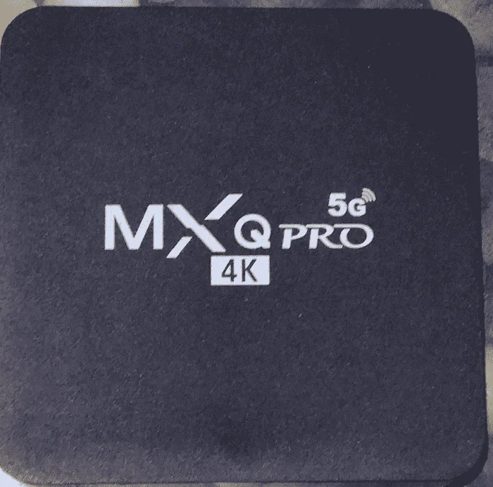

If your box has the white around the 4K like this one I have here it is rockchip:
If the 4K looks like it does in this next picture you have an Allwinner and this guide can't help you:

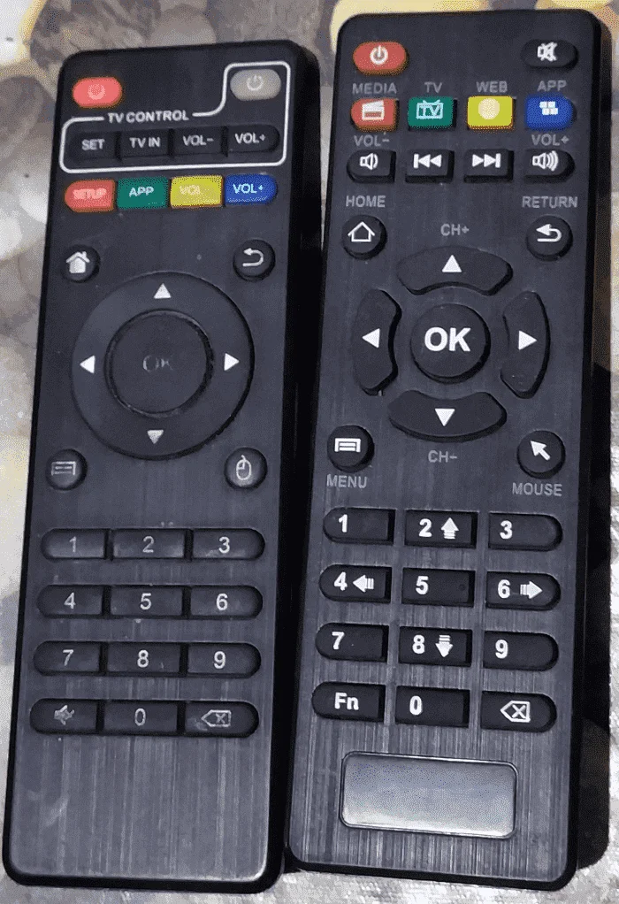

You can restore a backup from another MXQ box to one that is corrupted. This will clone the mac address of the box so if you're planning to use both boxes on the same network you need to repair the mac with a usb male to male cable and the software called Rockchip Android Tool. If you are making a repair business it's probably good practice to do this. There is no guarantee that this will work though. Sometimes boxes reject their firmware transplant and still won't boot. For these boxes you can search for KingboxRK-8703-7.1nv3-kodi-1225 and flash it over USB using RK batch tool. You should google that. Also you should understand that the remote that came with your box probably won't work anymore :ROFLMAO:. The common type with the clicky buttons instead of the raised buttons works on this firmware. In the picture below this you see the raised button variant on the right, clicky on the left. The clicky one is so much nicer anyway.
