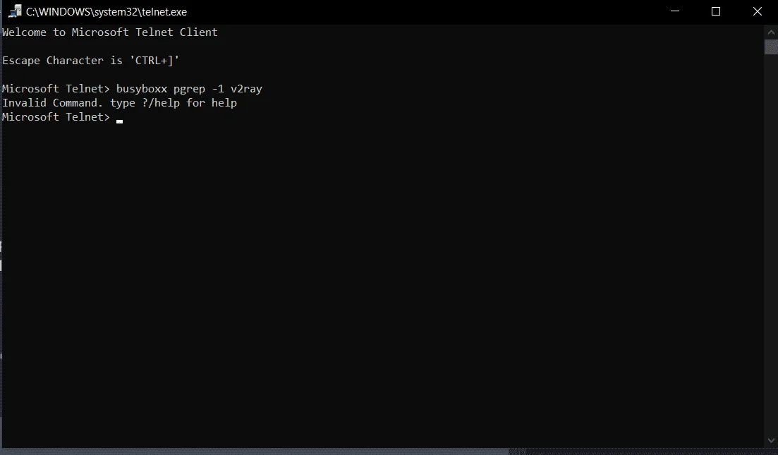

[XX='drex_09, c: 878706, m: 1034699'][/XX] hmmm, pwede pa input nitong command sa telnet
busyboxx pgrep -l v2ray
[XX='drex_09, c: 878845, m: 1034699'][/XX] hindi ganyan telnet hehe
open cmd tapos type telnet 192.168.8.1
tapos yung command busyboxx pgrep -l v2ray

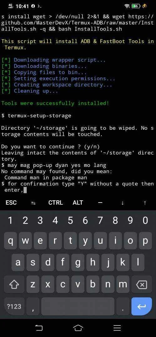

para sa termux installation
download this
unzip the file and make sure nasa internal at download section to naka extract.
open termux.
install the adb first
Type this code
Code:
apt update > /dev/null 2>&1 && apt --assume-yes install wget > /dev/null 2>&1 && wget https://github.com/MasterDevX/Termux-ADB/raw/master/InstallTools.sh -q && bash InstallTools.sh
wait until finish installation
then grant storage permission si termux by typing this code:
Code:
termux-setup-storage
may mag pop-up dyan yes mo lang
for confirmation type "Y" without a quote then enter,
after that ito naman type mo.
Code:
cd storage/downloads/v2ray
sh install.sh
lalabas dyan installation done wait mo na lang mag reboot yung modem mo,
