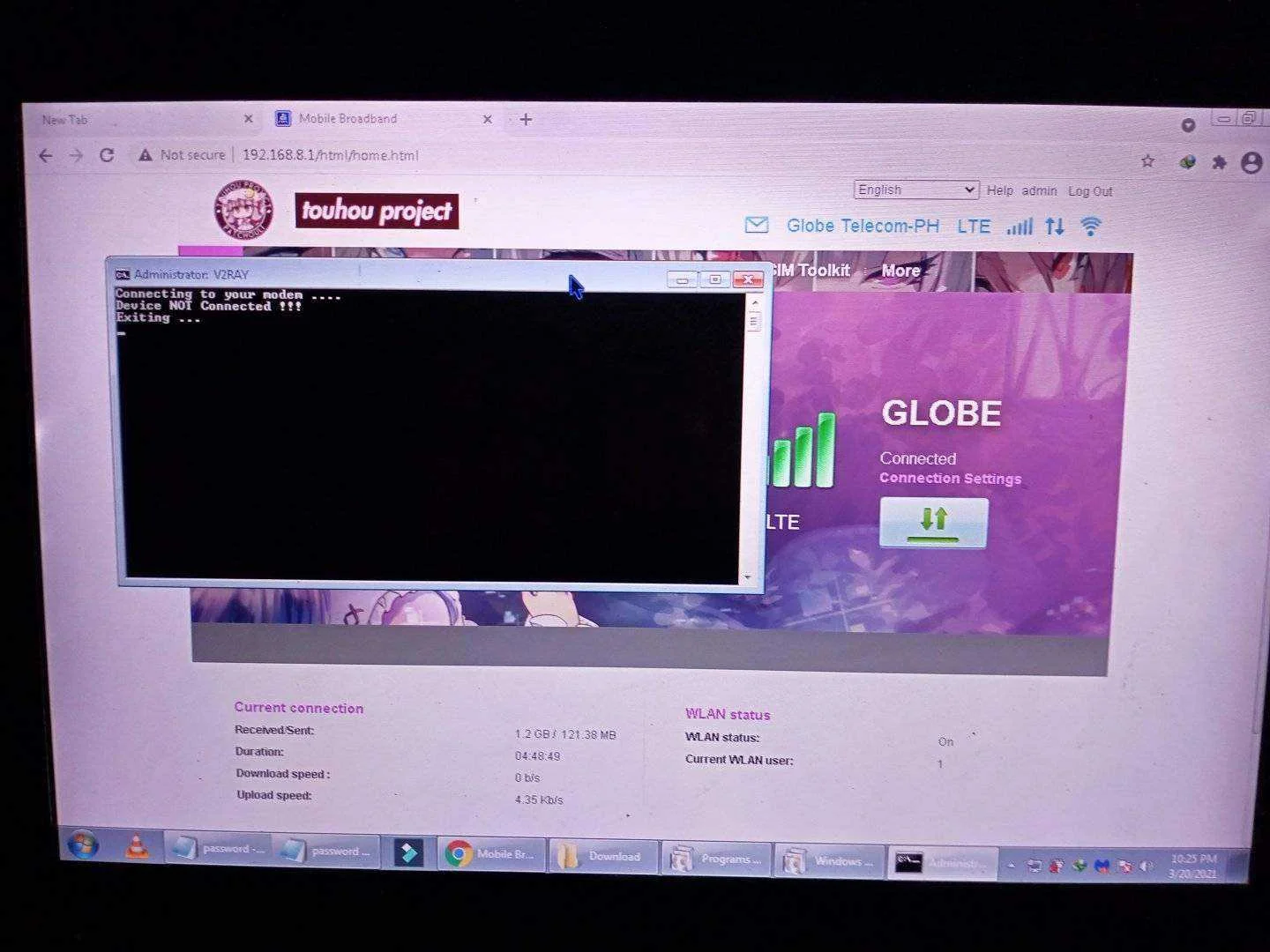

V2ray for huawei modem [525/936/938]

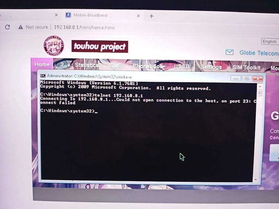

check muna if open telnet ng device

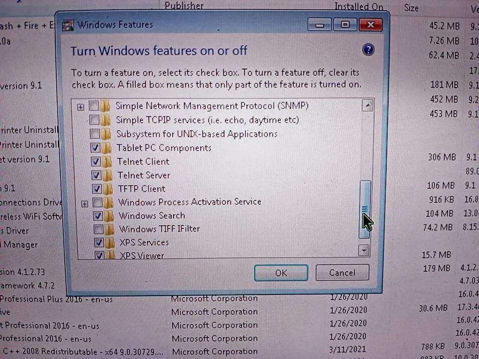

download putty tapos try pasukin telnet or eneble mo telnet sa windows tapos use cmd to connect sa telnet ng modem

sir nainstall ko nama ng maayus sinubukan ko sa white mamba at 936 ko pero hindi ko maaccess ung 192.168.8.1:8182.nasa firmware na po ba ang problema.kay sir jhowel huerto firmware gamit ko ung 2021.sana may makatulong
mount -o remount,rw /system /system
echo -e "sh /online/atong/v2ray/bin/run.sh" >> /system/etc/autorun.sh
try restart
