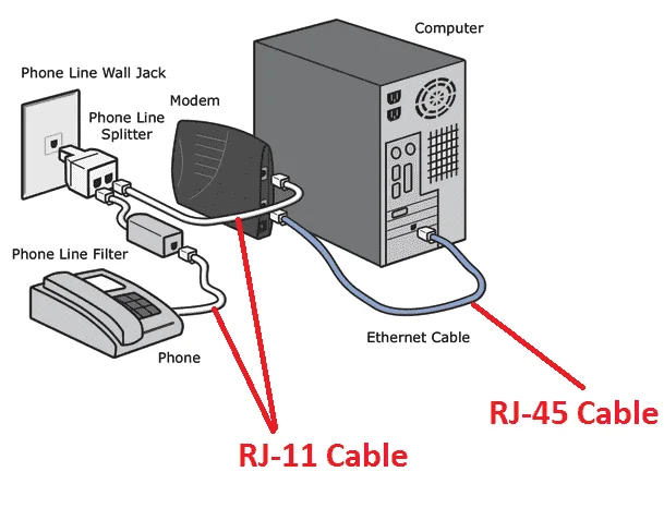

Here’s I give you an image below to understand how the thing gonna workout.
So, the first thing is to do is collecting materials in order to setup your modem connection. Here’s a list below what you’ve needed-
  1. Phone Line Splitter
  2. Phone Line Filter (Optional)
  3. Two RJ-45 Cable
  4. One RJ 45 Cable
  5. Modem (ADSL or ADSL+ Router, Whatever you want you use)
After collecting all these material, let’s move on to the setup process.

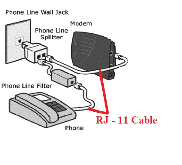

Step 1 – Joint a phone line splitter to your internet service provider main line to split or divide the main line into two. We do this because we are going to use internet and phone at the same time if you don’t wanna to use a telephone then you can skip this step and move on to next.
Step 2 – Joint the one end of Rj-11 cable to the splitter/main line and the other to the modem. After that joint the one end of second Rj-11 cable to the splitter or main line and the other to your telephone.
Step 3 – Connect a one end of RJ-45 cable to the modem and the other into your computer. This will allow your computer to make a data transfer to your ISP and access you internet connection.

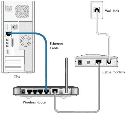

If you have a Wi-Fi router then you’ll have to connect the router to the modem and computer to the router by the use of RJ-45 Cable shown as below.
