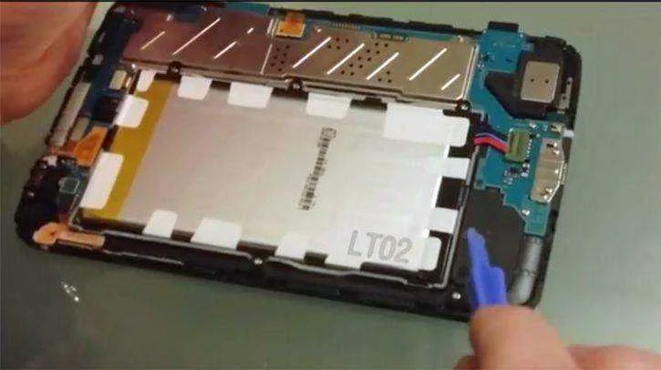

Getting the back off the Galaxy Tab 3 requires gently prying the edges away from the screen in the little crack between the screen and the case all around the perimeter of the screen. Doing this properly requires a thin plastic pry tool and some patience. I used a small jack knife, but would not recommend it as the metal can scratch the case or even potentially cause a short inside the unit if you're not careful. We have had readers write in to say guitar picks and old credit cards also can be used. By all means, be careful and DON'T FORCE IT! Work the pry tool around the edges until the screen separates from the back casing by itself without any force.

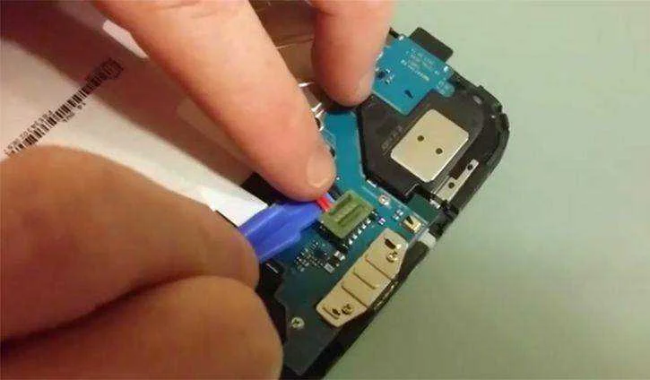

Once you pry away the back cover, you'll see a small set of wires on the right side that connect the battery to the unit.
Gently pry the battery connector up, then reconnect it after about a minute.
Once you've removed the back, gently separate the battery connector from its port by prying it toward you, then push it back down into place. Since originally writing this article, I've had to do this trick a few more times, and in some cases, I've had to leave the battery disconnected for over a minute in order for this to work. If a quick disconnect/reconnect of the battery does not work, then try leaving the battery disconnected for a full two minutes before reconnecting it. Replace the cover by gently placing the tablet back down into its shell and pushing along the perimeter, snapping all the pressure tabs back into place.
We've created a quick video on YouTube showing how to do this. It's a little rough but it should give you an idea how to get the case apart and disconnect and reconnect the battery.

Once you've put it all back together, plug the tablet into the factory wall charger and USB cable. Within about a minute you should see the battery icon appear and normal charging should begin. Be sure to use the original Samsung charging cable and wall charger. We've heard many reports of aftermarket USB cables and chargers not working as well, particularly in the case of charging problems like this.
