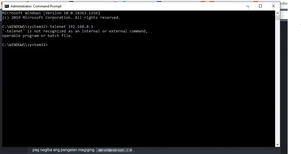

ganyan naman lumalabas sir pag sa cmd ko inoopen sir

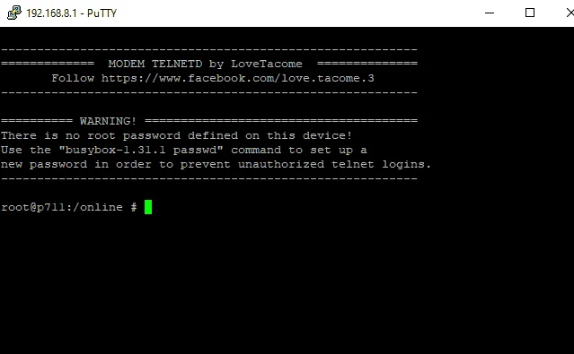

naka uninstall na sakin yung kay sir jerome sir kay love tacome nalang kaso yung firmware ko nun is naka enable yung adb nya which is kailangan naka disable ano gagawin ko po sir?
Iba iba po kasi ang ovpn na nainstalled sa mga modems. Iba iba ung path. Pag universal ung path, may chances na di rin mauuninstall ung nasa ibang path. Mas okay parin na manual atleast sure ka. Pero try ko gawa ng shell script yan. Di ko lang alam kung effective.
eto lang alam ko usually eto yung path pag uninstall
sh /online/vpn/bin/uninstall.sh
root@p711:/online # sh /online/vpn/bin/uninstall.sh
sh: /online/vpn/bin/uninstall.sh: No such file or directory
127|root@p711:/online #
127|root@p711:/online # root@p711:/online # sh /online/vpn/bin/uninstall.sh
ganyan naman lumalabas sir,
