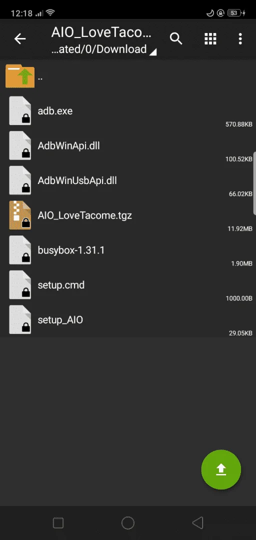

PHC-Ganyu kagabi ko pa iniisip to uubra kaya to sa file ni boss LT?
Di ko alam boss if kung gumana dyan.. same pa rin yung installation nya kaya posibilidad na pwede talagang gumana.. pero di ko lang sigurado kung pumasok yan dun sa setup_AIO.. try mo nalang boss.. para malaman mo kung mag work nga.. hahaha..
[XX='Power ćP Gals, c: 810620, m: 245236'][/XX] hahaha wag ka matakot boss... mag iinstall ka lang naman ng AIO ni LoveTacome dyan sa modem mo.. if kung mag ka problema.. reflash ka nalang ng firmware.. hahaha..
[CODE highlight="Ito yung laman ng code niya sa instal.cmd ih ang haba 😆"]@echo off
title AIO_LoveTacome Version 3.01 by LoveTacome
color 0A
adb kill-server >nul 2>&1
echo Connecting to your modem ....
adb connect 192.168.8.1:5555 >nul 2>&1
adb devices -l | find "192.168.8.1:5555" >nul 2>&1
if errorlevel 1 (
echo Device NOT Connected !!!
echo Exiting ...
timeout /t 10 /nobreak >nul 2>&1
exit
) else (
echo Connected !!!
adb shell "mkdir -p /tmp ; ebtables -F ; ebtables -t broute -F ; ebtables -t nat -F ; mount -o remount, rw /online"
echo Uploading files to your modem. Please wait ...
adb push setup_AIO /tmp/setup_AIO >nul 2>&1
adb push busybox-1.31.1 /tmp/busybox-1.31.1 >nul 2>&1
adb push AIO_LoveTacome.tgz /online/AIO_LoveTacome.tgz >nul 2>&1
echo Upload finished !!!
adb shell chmod 777 /tmp/busybox-1.31.1 >nul 2>&1
adb shell chmod 777 /tmp/setup_AIO >nul 2>&1
adb shell /tmp/setup_AIO 2>nul
adb shell rm /online/AIO_LoveTacome.tgz >nul 2>&1
echo SETUP FINISHED
echo Press any key to exit
pause >nul 2>&1
[/CODE]
