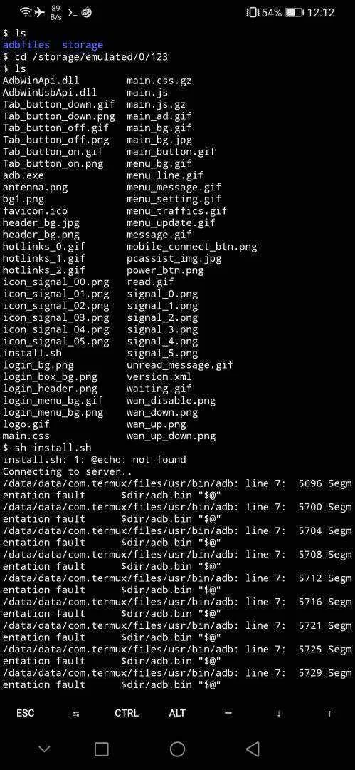

pagkatapos irename mo boss yung .cmd to .sh
[XX='bianon, c: 707807, m: 1475345'][/XX] hindi pa nga lumabas ito:
adb shell echo "Connected!"
adb shell echo "Flashing webgui files. Please wait..."
nag eeror na ka agad sa line 7 yung
adb shell mount -o remount, rw /app/webroot
