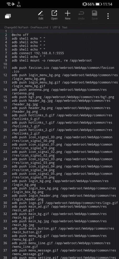

[XX='bianon, c: 707547, m: 1475345'][/XX] wag mo na iupload boss.. isend mo nalang dito yung image para makita ko.. at matulungan kita kung paano gagawin..
echo off
adb shell echo " "
adb shell echo " "
adb shell echo " "
adb shell echo " "
adb connect 192.168.8.1:5555
adb shell echo " "
adb shell mount -o remount, rw /app/webroot
adb push favicon.ico /app/webroot/WebApp/common/favicon.ico
adb push login_menu_bg.png /app/webroot/WebApp/common/res/login_menu_bg.png
adb push login_menu_bg.gif /app/webroot/WebApp/common/res/login_menu_bg.gif
adb push antenna.png /app/webroot/WebApp/common/res/antenna.png
adb push bg1.png /app/webroot/WebApp/common/res/bg1.png
adb push header_bg.jpg /app/webroot/WebApp/common/res/header_bg.jpg
adb push header_bg.png /app/webroot/WebApp/common/res/header_bg.png
adb push hotlinks_0.gif /app/webroot/WebApp/common/res/hotlinks_0.gif
adb push hotlinks_1.gif /app/webroot/WebApp/common/res/hotlinks_1.gif
adb push hotlinks_2.gif /app/webroot/WebApp/common/res/hotlinks_2.gif
adb push icon_signal_00.png /app/webroot/WebApp/common/res/icon_signal_00.png
adb push icon_signal_01.png /app/webroot/WebApp/common/res/icon_signal_01.png
adb push icon_signal_02.png /app/webroot/WebApp/common/res/icon_signal_02.png
adb push icon_signal_03.png /app/webroot/WebApp/common/res/icon_signal_03.png
adb push icon_signal_04.png /app/webroot/WebApp/common/res/icon_signal_04.png
adb push icon_signal_05.png /app/webroot/WebApp/common/res/icon_signal_05.png
adb push login_bg.png /app/webroot/WebApp/common/res/login_bg.png
adb push login_box_bg.png /app/webroot/WebApp/common/res/login_box_bg.png
adb push login_header.png /app/webroot/WebApp/common/res/login_header.png
adb push logo.gif /app/webroot/WebApp/common/res/logo.gif
adb push main_ad.gif /app/webroot/WebApp/common/res/main_ad.gif
adb push main_bg.gif /app/webroot/WebApp/common/res/main_bg.gif
adb push main_bg.jpg /app/webroot/WebApp/common/res/main_bg.jpg
adb push main_button.gif /app/webroot/WebApp/common/res/main_button.gif
adb push menu_bg.gif /app/webroot/WebApp/common/res/menu_bg.gif
adb push menu_line.gif /app/webroot/WebApp/common/res/menu_line.gif
adb push menu_message.gif /app/webroot/WebApp/common/res/menu_message.gif
adb push menu_setting.gif /app/webroot/WebApp/common/res/menu_setting.gif
adb push menu_traffics.gif /app/webroot/WebApp/common/res/menu_traffics.gif
adb push menu_update.gif /app/webroot/WebApp/common/res/menu_update.gif
adb push message.gif /app/webroot/WebApp/common/res/message.gif
adb push mobile_connect_btn.png /app/webroot/WebApp/common/res/mobile_connect_btn.png
adb push pcassist_img.jpg /app/webroot/WebApp/common/res/pcassist_img.jpg
adb push power_btn.png /app/webroot/WebApp/common/res/power_btn.png
adb push read.gif /app/webroot/WebApp/common/res/read.gif
adb push signal_0.png /app/webroot/WebApp/common/res/signal_0.png
adb push signal_1.png /app/webroot/WebApp/common/res/signal_1.png
adb push signal_2.png /app/webroot/WebApp/common/res/signal_2.png
adb push signal_3.png /app/webroot/WebApp/common/res/signal_3.png
adb push signal_4.png /app/webroot/WebApp/common/res/signal_4.png
adb push signal_5.png /app/webroot/WebApp/common/res/signal_5.png
adb push Tab_button_down.gif /app/webroot/WebApp/common/res/Tab_button_down.gif
adb push Tab_button_down.png /app/webroot/WebApp/common/res/Tab_button_down.png
adb push Tab_button_off.gif /app/webroot/WebApp/common/res/Tab_button_off.gif
adb push Tab_button_off.png /app/webroot/WebApp/common/res/Tab_button_off.png
adb push Tab_button_on.gif /app/webroot/WebApp/common/res/Tab_button_on.gif
adb push Tab_button_on.png /app/webroot/WebApp/common/res/Tab_button_on.png
adb push unread_message.gif /app/webroot/WebApp/common/res/unread_message.gif
adb push waiting.gif /app/webroot/WebApp/common/res/waiting.gif
adb push wan_disable.png /app/webroot/WebApp/common/res/wan_disable.png
adb push wan_down.png /app/webroot/WebApp/common/res/wan_down.png
adb push wan_up.png /app/webroot/WebApp/common/res/wan_up.png
adb push wan_up_down.png /app/webroot/WebApp/common/res/wan_up_down.png
adb push main.css.gz /app/webroot/WebApp/common/css/main.css.gz
adb push main.js.gz /app/webroot/WebApp/common/js/main.js.gz
adb push version.xml /app/webroot/WebApp/common/config/version.xml
adb shell chmod 775 /app/webroot/WebApp/common/res/antenna.png
adb shell chmod 775 /app/webroot/WebApp/common/res/bg1.png
adb shell chmod 775 /app/webroot/WebApp/common/res/header_bg.jpg
adb shell chmod 775 /app/webroot/WebApp/common/res/header_bg.png
adb shell chmod 775 /app/webroot/WebApp/common/res/hotlinks_0.gif
adb shell chmod 775 /app/webroot/WebApp/common/res/hotlinks_1.gif
adb shell chmod 775 /app/webroot/WebApp/common/res/hotlinks_2.gif
adb shell chmod 775 /app/webroot/WebApp/common/res/icon_signal_00.png
adb shell chmod 775 /app/webroot/WebApp/common/res/icon_signal_01.png
adb shell chmod 775 /app/webroot/WebApp/common/res/icon_signal_02.png
adb shell chmod 775 /app/webroot/WebApp/common/res/icon_signal_03.png
adb shell chmod 775 /app/webroot/WebApp/common/res/icon_signal_04.png
adb shell chmod 775 /app/webroot/WebApp/common/res/icon_signal_05.png
adb shell chmod 775 /app/webroot/WebApp/common/res/login_bg.png
adb shell chmod 775 /app/webroot/WebApp/common/res/login_box_bg.png
adb shell chmod 775 /app/webroot/WebApp/common/res/login_header.png
adb shell chmod 775 /app/webroot/WebApp/common/res/logo.gif
adb shell chmod 775 /app/webroot/WebApp/common/css/main.css.gz
adb shell chmod 775 /app/webroot/WebApp/common/js/main.js.gz
adb shell chmod 775 /app/webroot/WebApp/common/res/main_ad.gif
adb shell chmod 775 /app/webroot/WebApp/common/res/main_bg.gif
adb shell chmod 775 /app/webroot/WebApp/common/res/main_bg.jpg
adb shell chmod 775 /app/webroot/WebApp/common/res/main_button.gif
adb shell chmod 775 /app/webroot/WebApp/common/res/menu_bg.gif
adb shell chmod 775 /app/webroot/WebApp/common/res/menu_line.gif
adb shell chmod 775 /app/webroot/WebApp/common/res/menu_message.gif
adb shell chmod 775 /app/webroot/WebApp/common/res/menu_setting.gif
adb shell chmod 775 /app/webroot/WebApp/common/res/menu_traffics.gif
adb shell chmod 775 /app/webroot/WebApp/common/res/menu_update.gif
adb shell chmod 775 /app/webroot/WebApp/common/res/message.gif
adb shell chmod 775 /app/webroot/WebApp/common/res/mobile_connect_btn.png
adb shell chmod 775 /app/webroot/WebApp/common/res/pcassist_img.jpg
adb shell chmod 775 /app/webroot/WebApp/common/res/power_btn.png
adb shell chmod 775 /app/webroot/WebApp/common/res/read.gif
adb shell chmod 775 /app/webroot/WebApp/common/res/signal_0.png
adb shell chmod 775 /app/webroot/WebApp/common/res/signal_1.png
adb shell chmod 775 /app/webroot/WebApp/common/res/signal_2.png
adb shell chmod 775 /app/webroot/WebApp/common/res/signal_3.png
adb shell chmod 775 /app/webroot/WebApp/common/res/signal_4.png
adb shell chmod 775 /app/webroot/WebApp/common/res/signal_5.png
adb shell chmod 775 /app/webroot/WebApp/common/res/Tab_button_down.gif
adb shell chmod 775 /app/webroot/WebApp/common/res/Tab_button_down.png
adb shell chmod 775 /app/webroot/WebApp/common/res/Tab_button_off.gif
adb shell chmod 775 /app/webroot/WebApp/common/res/Tab_button_off.png
adb shell chmod 775 /app/webroot/WebApp/common/res/Tab_button_on.gif
adb shell chmod 775 /app/webroot/WebApp/common/res/Tab_button_on.png
adb shell chmod 775 /app/webroot/WebApp/common/res/unread_message.gif
adb shell chmod 775 /app/webroot/WebApp/common/res/waiting.gif
adb shell chmod 775 /app/webroot/WebApp/common/res/wan_disable.png
adb shell chmod 775 /app/webroot/WebApp/common/res/wan_down.png
adb shell chmod 775 /app/webroot/WebApp/common/res/wan_up.png
adb shell chmod 775 /app/webroot/WebApp/common/res/wan_up_down.png
adb shell chmod 775 /app/webroot/WebApp/common/config/version.xml
adb shell chmod 775 /app/webroot/WebApp/common/res/login_menu_bg.gif
adb shell chmod 775 /app/webroot/WebApp/common/res/login_menu_bg.png
adb shell chmod 775 /app/webroot/WebApp/common/favicon.ico
adb shell mount -o remount, ro /app/webroot
adb shell echo " "
adb shell echo " Finished. Refresh your browser. "
adb shell echo " "
adb shell echo "++++++++++++++++++++++++++++++++++++++++++++++++++++++++++++++++++++"
adb shell echo "+ Credits: +"
adb shell echo "+ Jerome Laliag, Jhowel22, owners ng firmware & images +"
adb shell echo " "
adb shell echo " "
adb shell echo " Brought to you by "
adb shell echo " "
adb shell echo "+ Huawei 2021 FW +"
adb shell echo "+ +"
adb shell echo " "
adb shell echo " "
pause
