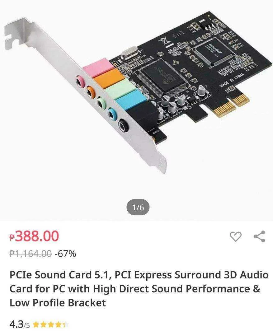

Ganito po bumili ako ng sound card kase nasira yung builtin sound ng mobo, yung pcie sound card po picture below. Kaso pag nakasalpak at magpa music o kahit anong sound, biglaan nlang talaga mag shutdown hindi naman po BSOD, shutdown lang talaga as if pinindut yung reset button sa case, alam ko yan kase pag pinindut yung reset btn lalakas lahat ng fan, same case sa sound card shutdown lumalakas lahat fan.
Na try ko na lahat pati sa win 7, 8+, at clean reinstall 10. Ganun parin po. Nauubosan nako ng options.
Tanong ko po ano kaya nangyayari? Sayang naman pera e hassle mag return ngayon. Kung sa PSU naman hindi naman siguro ganun kabigat sa kuryente. Mas mabigat pa nga gpu ko e kaya naman po. Hirap din hanapan ng power rating nito diko talaga mahanap.
Ito po yung sound card.

hardware error, bios is detecting excessive heat its the main reason for fan to compensate the the heat, if not compensated it will shut down your system unit to not cause from further damages...check the reliability of your new hardware from its manufacturer or have it replace sir.
Yun na nga sobrang nakakalito lods e, okay lahat pag walang driver walang shutdown so you think na driver problem wala sa OS, pro pag sa ibang OS naman exactly the same parin problem pag naka install na another separate driver so parang hardware narin. Nakakabagot na talaga :ROFLMAO:
Thanks but I think it's not the temps.. because if you press it continuously it really just speeds the fan regardless if it's cold, same with sound card shutdown. I also have the entire system unit out of the case so I can monitor everything up close. Still can't pinpoint the problem..
