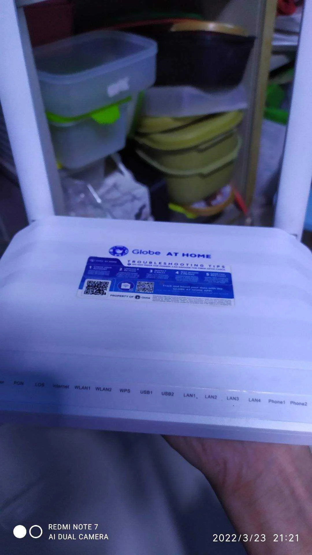

Para sa mga may Globe DN8245W na modems jan na di na nagagamit,
Success, Working yung Globe DN8245W as Wifi repeater/extender sa PLDT DSL RN104R4GC-2T2R-A5 modem sakin, Try nyo nlang sa PLDT modems nyo or ibang Modems.

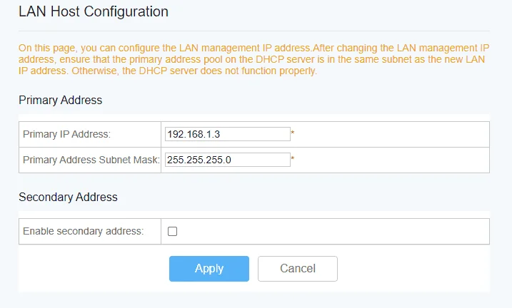

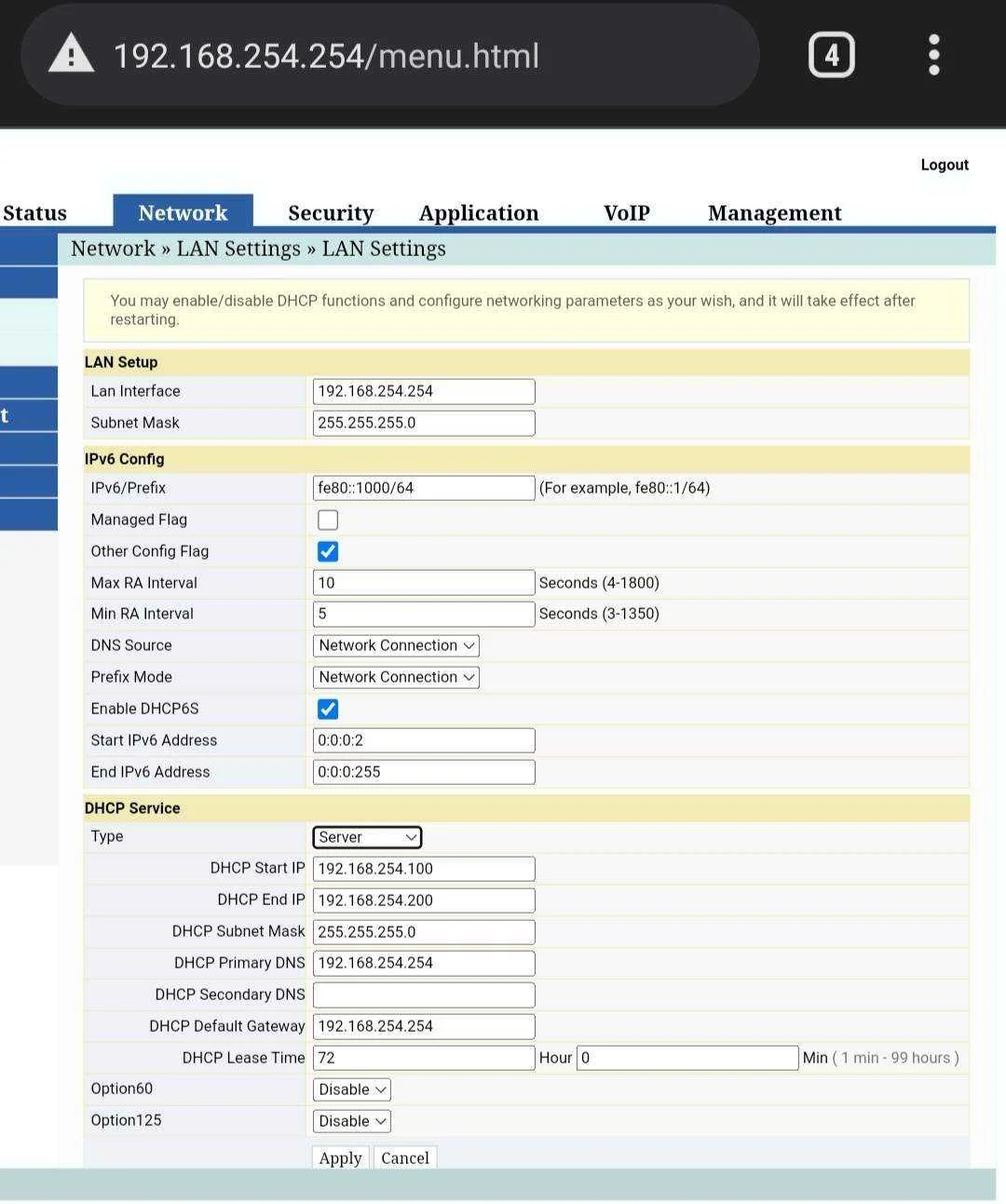

1. Open globe modem. go to Lan configuration, change primary IP address from 192.168.254.254 to 192.168.1.3 or 4(depends on your PLDT Ip gateway) then apply/save.

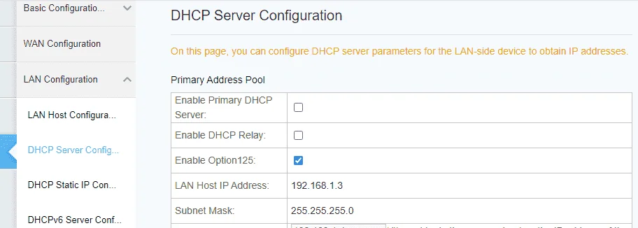

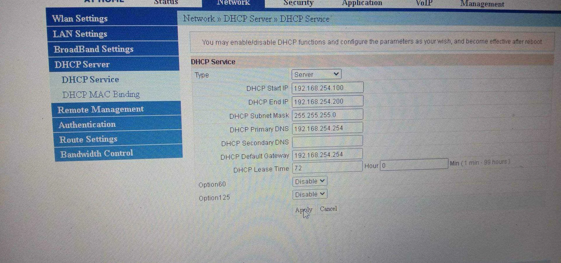

2.Go to DHCP Server Configuration, Uncheck Enable Primary DHCP Server and Enable DHCP Relay then apply/save.
