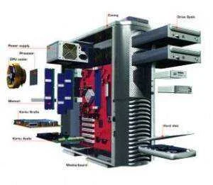

Hardware Detection Problems:
  1. Power Supply
  2. Motherboard
  3. Speaker
  4. RAM
  5. VGA Card + Monitor
  6. Keyboard
  7. Card I/O
  8. Disk Drive
