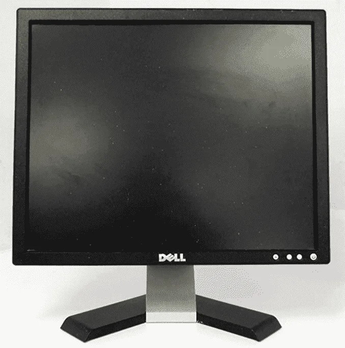

May extra 17 inch monitor kami sa bahay any tips po pano to magamit para maging tv?
Ano kaya device pwede i connect dito?
need advice po salamat :)

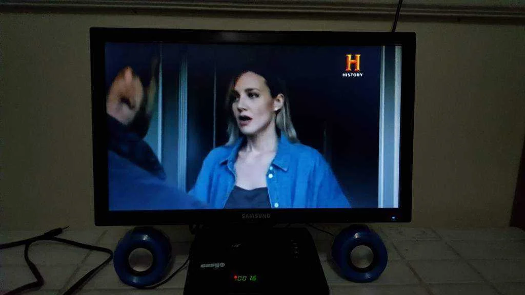

bili ka muna nito sa lazada or shoppee:
dito mo isaksak yung video out ng TV box
tapos yung sound mo is gamit yung usb speaker.

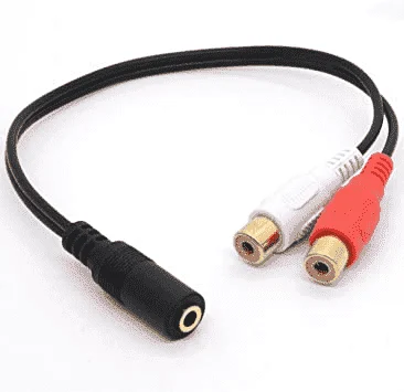

need mo rin nito
3.5mm Female to Dual RCA Female Phono Stereo Splitter Cable
Dito mo isaksak yung audio ng TV box to speaker.

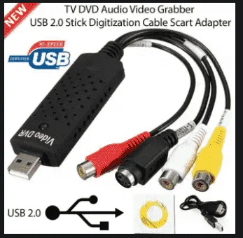

Kung gusto mo gamitan ng CPU, puede rin ito:
tapos puede mong irecord yung mga palabas sa TV box na gusto mo.
@URL..https://www.lazada.com.ph/products/easycap-usb-20-easy-cap-video-tv-dvd-vhs-dvr-capture-card-easier-cap-usb-video-capture-device-support-win10-i772724587.html[/URL]
@ATTACH..type="full" alt="1606223057945.png"]1060133[/ATTACH]
pwede to gamitin sa laptop?
