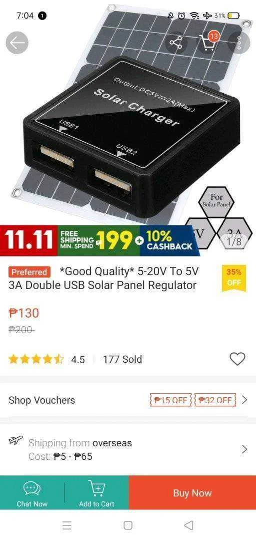

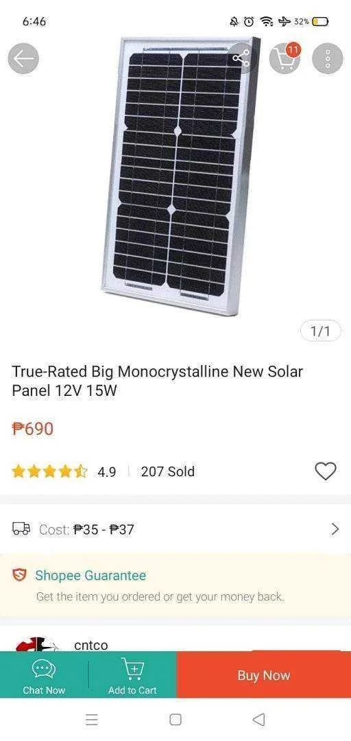

Pwede na po ba ito ? Kaya na po ba mag charge ng cell phone fast charging po? Newbie po about jan naguguluhan po ako .need help thanks in advance

If isa lang na solar panel parang hindi kaya sa 3A na charger ang computation ko is 3A at 12v mga 36W eh so hindi kaya yan need mo ng 3 na solar panel at parallel
Pwede natry ko na, directa from solar, no battery,regulator lang at npn + 2ecaps, yung 7805 regulartor,and d718 npn transistor. 5-6A output.Pm if you want, turo ko kung paano siya. Simple lang po.
Yong pang charge na po
freend need pa po ba ng transistor po? Safe po ba yang regulator lang at solar po?
