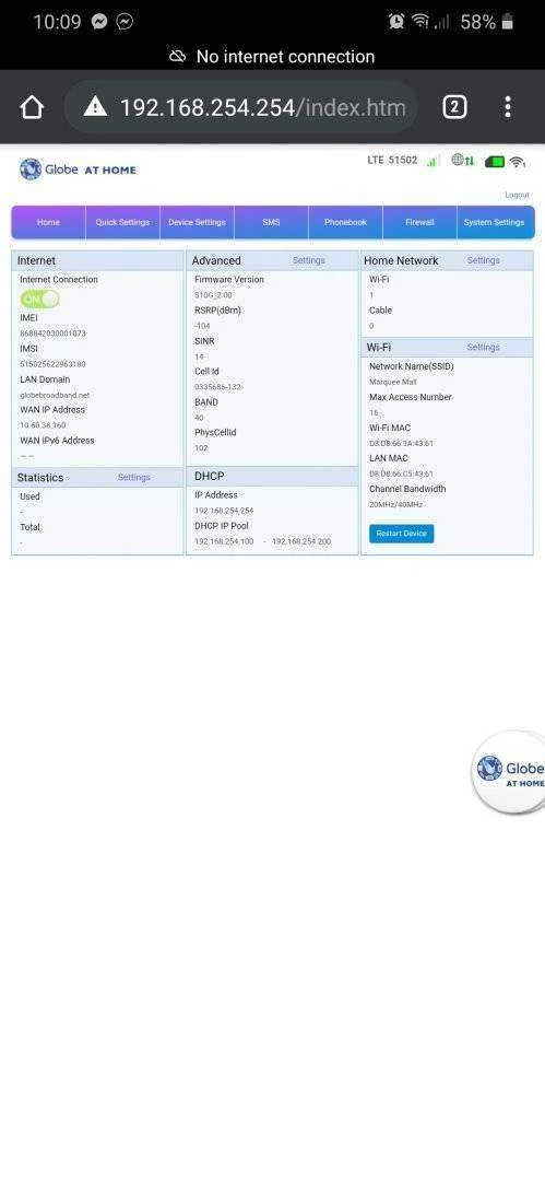

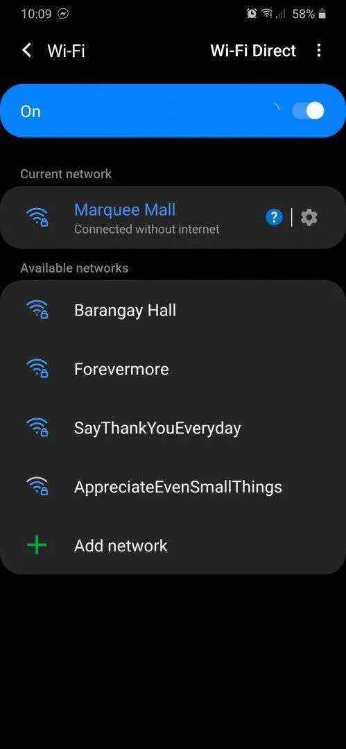

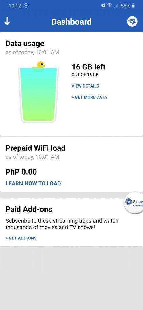

no internet connection daw pero may data naman sa globe at home app
baka may naka experience na neto dito at paano nyo naayos?
nag factory reset nako chance band etc

mali ang IMEI mo, pang PLDT yan dahil sa 8688** prefix, di gagana ang globe at home sim dyan, change mo by this command
pagkatpos mag login either user or admin, go to System Settings, click mo yung 1st tab menu at the right twice
then change url 192.168.254.254/...#system_settings something like this to 192.168.254.254/...#send_at
command: at^modimei = 866002031557977
ilagay mo yan sa command bar, then restart your device
