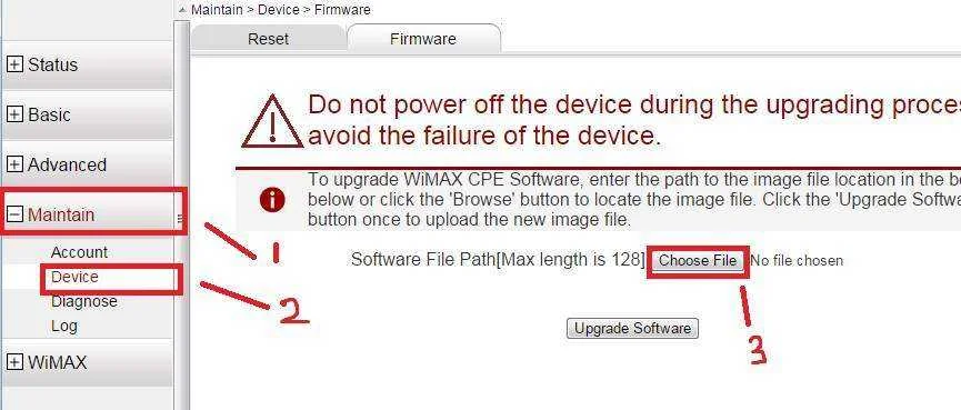

Para sa mga nagrerequest ng proper downgrading ng bm623m
sensya na isa lang screenshot,mag aalaga pako ng bata hahaha
PART I
192.168.254.254
log in as admin
1, Click Maintain
2,Click Device
3, Choose the file of your Firmware (imageFile .Tar)
