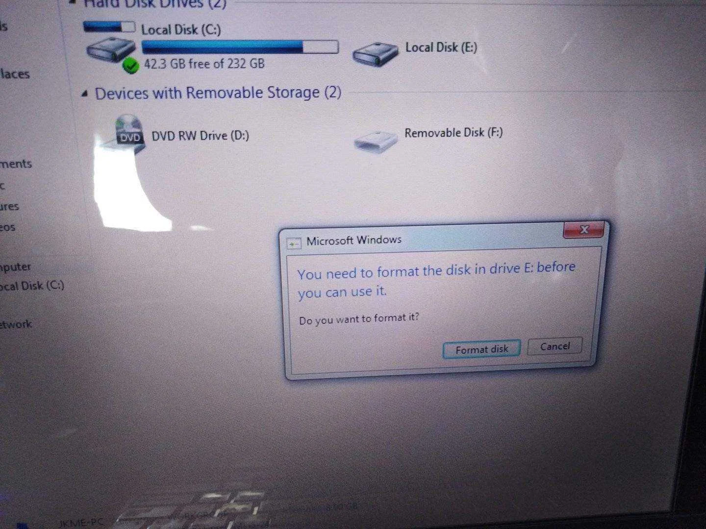

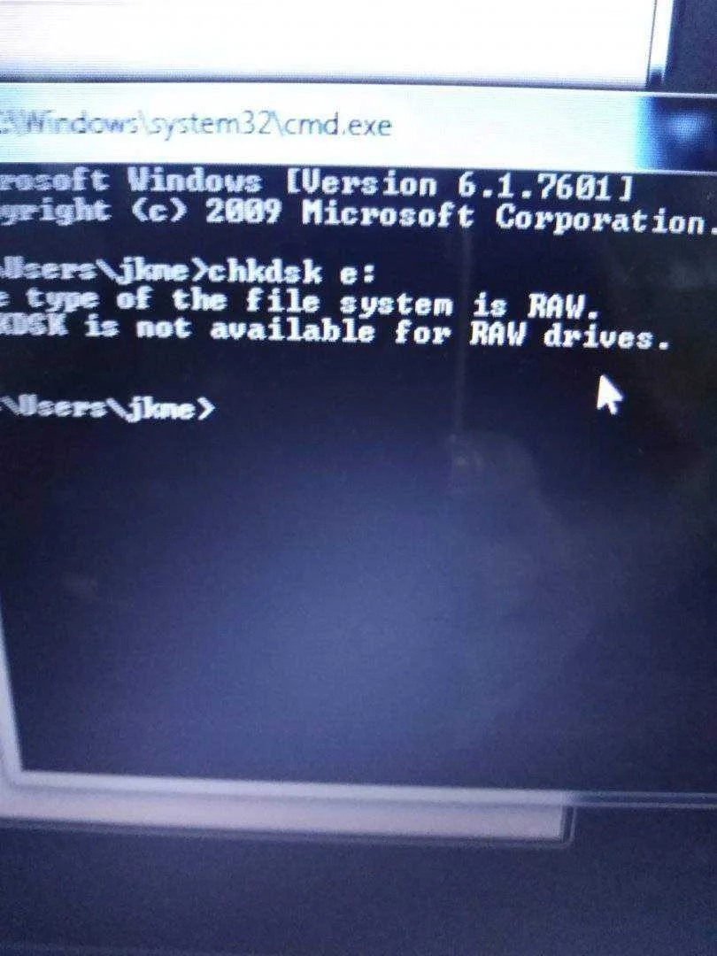

lods try mo isalpak sa linux os yan hdd mo. dun mo try i access pag thesame pa din problem, then try palit ka module board ng hdd mo if may pang hiraman ka or swap lng to check the integrity ng hdd and troubleshoot narin. if d parin gumana read about data recovery after format.
this is just an idea not even 90% proven to work on ur case am not liable to any further damage it may cause if you decide to do the things i just said. good luck.
agree ako sa sabi nitong sa taas ko
download ka na lang ng ISO linux distro try mo yung linux mint tapos gawin mong bootable tapos boot mo sya sa pc mo pero wag mo iinstall, try mo lang yung linux wag install, tapos check mo kung makikita mo yung mga files mo, pero kung same parin ng issue need mo na mag reformat or gumamit ng apps para ma recover mo,
noted boss magDL ako ng linux OS... lods ask ko lang din if wla bang kaso if gagawin kong primary HDD sa pc ung HDD ng laptop?... nag aalangan lang kz ako baka magover heat...5v lang kz ung hdd n pang laptop... salamats mga lods
lods live os linux gamitin mo, preferably ung may pre installed na gparted for hdd/ssd.
sa issue about making ur hdd of ur loppy as primary for ur desktop base for my own experience wala na man problema ts basta ba ung hdd port is suported ng psu and mobo.
downside nyan is mounting sa bay and sa performance by speed tsaka mas tipid ata sa current ung desktop hdd.
