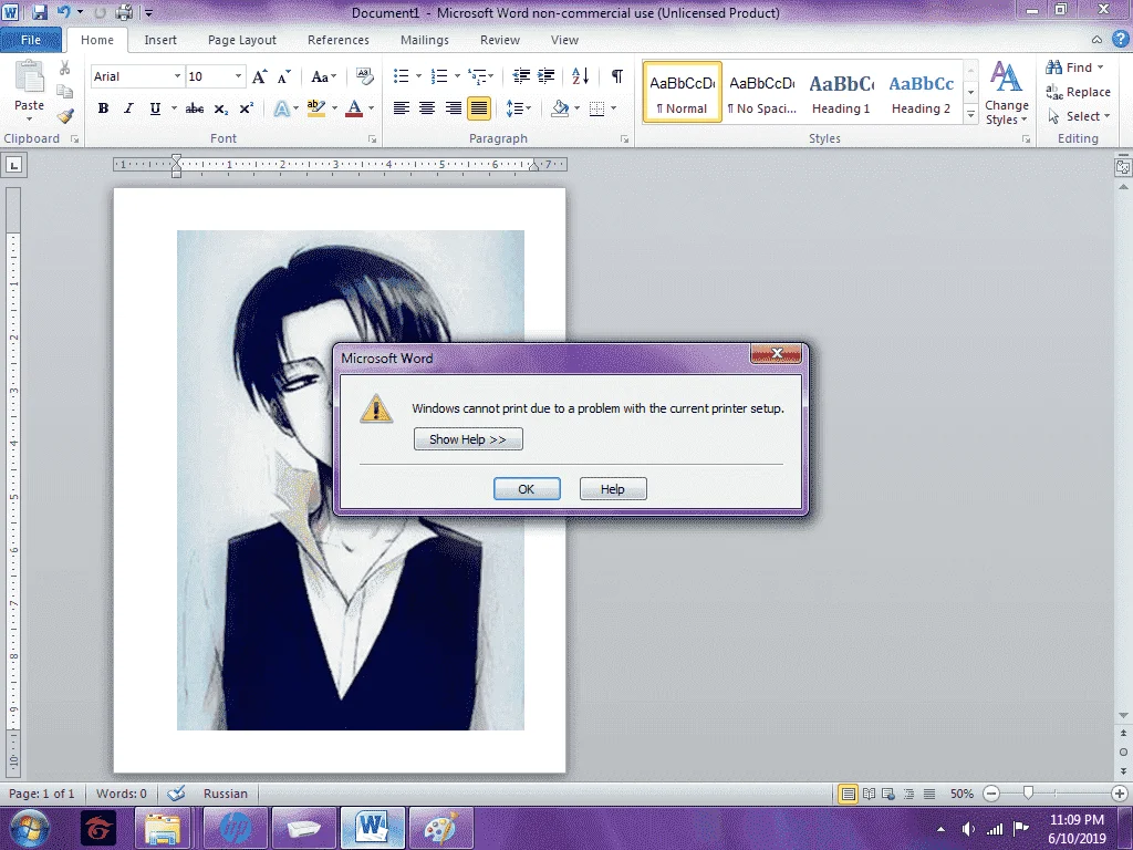

Ayaw Kasi mag print Ng printer Namin may ganyan na lumalabas, drivers Lang po kaya problem mga masters, Di Kasi ako masyado maalam Jan hehe 😅
Salamat po sa inyo

try mo remove or delete yung printer muna sa devices and printers tapos hugutin mo muna yung printer then plugin mo ulit, mag automatic install yang printer mo, pero kung hindi try mo mag install ulit ng driver

Bale sir, nag uninstall reinstall na po ako, ganyan parin po lumalabas.

try manually removing printer driver
To completely remove printer driver files from a system:
Open the Print Server Properties dialog window by doing one of the following:
Click the Start menu and in the search field type printui /s /t2 and then press Enter or click it in the search list.
or
Press WINDOWS+R on the keyboard to bring up the Run window, type in printui /s /t2 and then press Enter or click OK.
or
Press the WINDOWS key on the keyboard to display the Start screen, type in printui /s /t2 and then click it in the search list.
From the Start menu or the Start screen:
Open Devices and Printers.
Select any printer and then click "Print server properties" at the top of the window.
Click on the Drivers tab.
Select the printer driver to uninstall.
Click the Remove button.
Select "Remove driver and driver package" and click OK.
Note: Removing the driver package will clear all driver installation files for that device,
leaving no reference to the printer that Windows could possibly use to auto-reinstall again.
