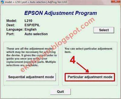

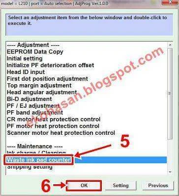

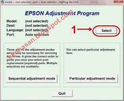

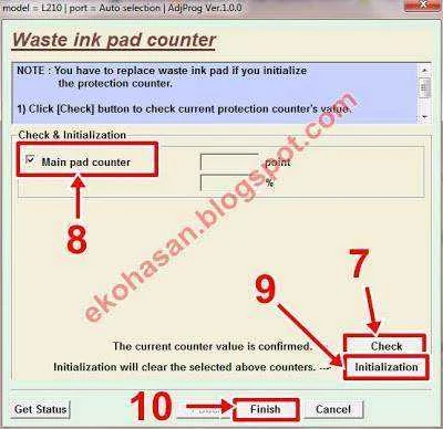

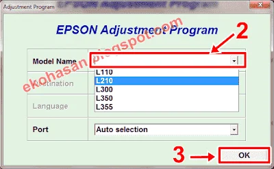

How to reset Resetter Epson L110 L210 L300 L350 L355
If Epson L110 L210 L300 L350 L355 quit or strike a print , the printer Epson L110 L210 L300 L350 L355 reset your request . Here's how to reset epson L110 L210 L300 L350 L355 :
1 . Turn on Printer and Printer Driver must be installed on the computer .
2 . Download Resetter Program Epson L110 L210 L300 L350 L355 , at the end of this posting
3. Run the Resetter Epson L110 L210 L300 L350 L355 with double click on Adjprogcracked.exe
4 . Then follow this guide following picture :
Properties of http://ekohasan.phc.onl/#forbidden#/
After you run the instructions in the order of images, the Epson L110 L210 L300 L350 L355
You will be ready to use your Epson L210 again .
