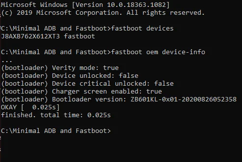

no recovery mode
only csc fastboot mode
flashing is not allowed in lock_state
some fastboot cmds are not working. such as:
fastboot oem unlock
fastboot flashing unlock
atbp..
sinubukan ko na rin gumamit unlock.bat pero mag-rrestart then after logo shutdown pa rin supposed to be it will be direct to further instructions.
FYI: is there other way na ma unlock ko si bootloader, yun lang need ko. then pwd ko na sya iflash..

na try ko na yan lods. pero (Flashing is not allowed in Lock_State), nasa description naman so bago mag flash dapat naka unlock muna device mo. yun problem ko lods. di ko naman mabubuksan dev options kasi nga dko mabuksan phone.
kaya ask ko is there other way to unlock bootloader using csc fastboot mode only.
