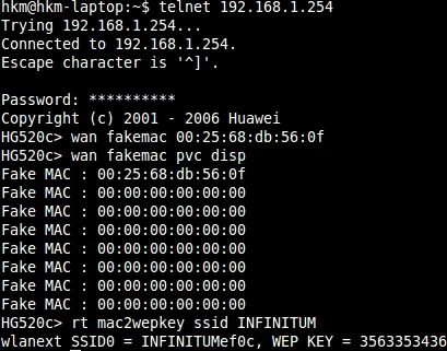

Huawei router models HG520b and HG520c contain a key generator command (mac2wepkey) in their TELNET interface. They also contain a command to change the MAC address (fakemac).
It is possible to change our MAC to generate the default WEP key of a MAC of our choosing.
Obtaining the default WEP and SSID of another MAC address

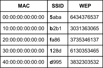

The first step was generating some lists containing MAC, SSID and WEP keys of about 200 entries and trying to identify patterns. The first thing we noticed was that the WEP key had values from 30 to 39 and from 61 to 66. These values correspond to the numbers 1 to 9 and letters a-f in ASCII.
Default WEP KEY and SSID in Huawei routers
After analyzing the lists we noticed that the numbers are repeated in pairs, so by forming several lists we could predict the next SSID and WEP key. Then by looking at how the bits changed, we were able to identify the XOR function.
The first lists were generated with the help of the mac2wepkey command in the TELNET interface of the modem. The lists were generated for the first byte of the MAC address:
With MAC 00:00:00:00:00:00 we get the base SSID (5aba) and base WEP (6434376537).

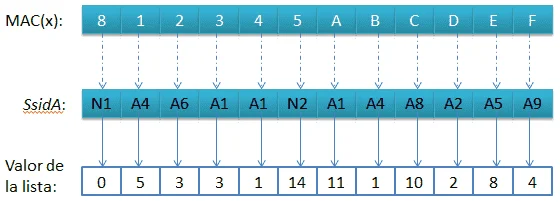

Now for a complete example we will use MAC(x): 81:23:45:AB:CD:EF
Each byte corresponds to a different list
The list SsidA contains the necessary lists to obtain the first character of the SSID. The first byte of the MAC corresponds to the list N1.
The value of the first byte is 8, if we look it up on the list N1, its value corresponds to 0.
In the same way we obtain each value for all 12 bytes of the MAC address.
Once we have all 12 values, we apply XOR adding the first byte of the base SSID (5aba).
This results in a value of 1, which is the first byte of the final SSID(x). We repeat the same process for all 4 SSID lists and we obtain:
