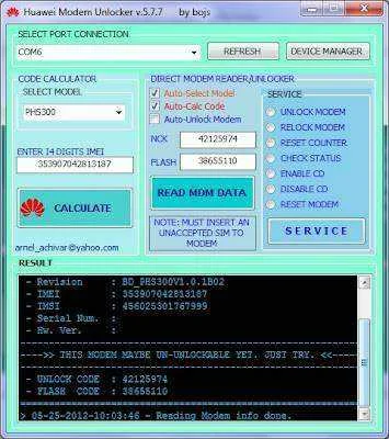

Try mo to boss:
1. Download mo to You do not have permission to view the full content of this post. Log in or register now. (Huawei Modem Unlocker by Bojs 5.7.7)
2. Plug mo yung modem mo sa PC or laptop using USB Cable
3. Choose mo yung COM Port ng modem mo (example COM6)
4. Press READ MDM DATA (wait mo mag message sa Reading done check mo pic sa ilalim)
5. Sa Service na Menus click mo RESET COUNTER
6. Press SERVICE na button
7. Do it at your won risk

a cge po try ko bukas . sna mag work .. maraming salamat boss .. godbless po

Thanks a lot sir tendou26 gumana po siya kaagad unlock v3 code ginamit ko (y):athumbsup: itatanong ko lang po kung para saan yung itong Flash:34556370?
